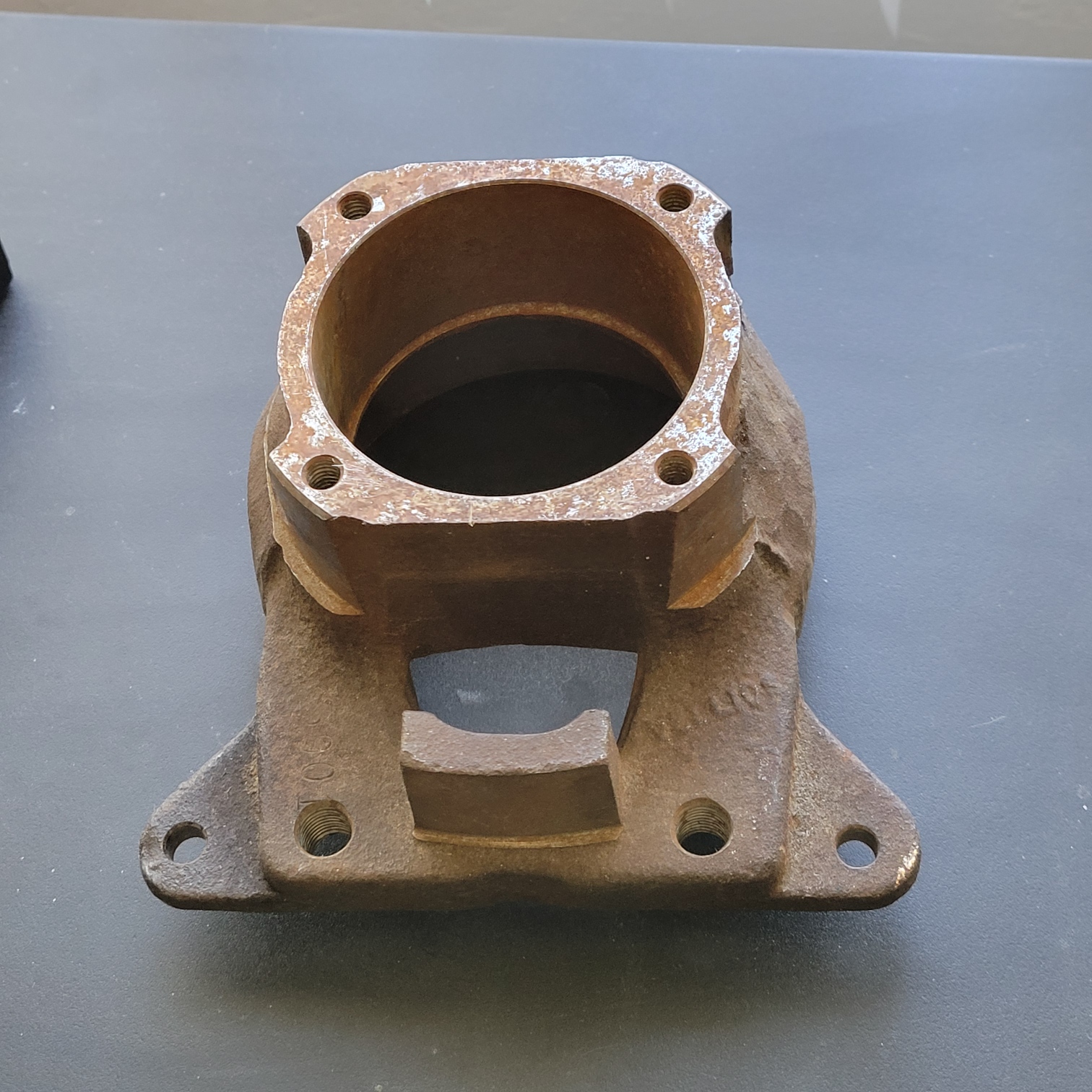

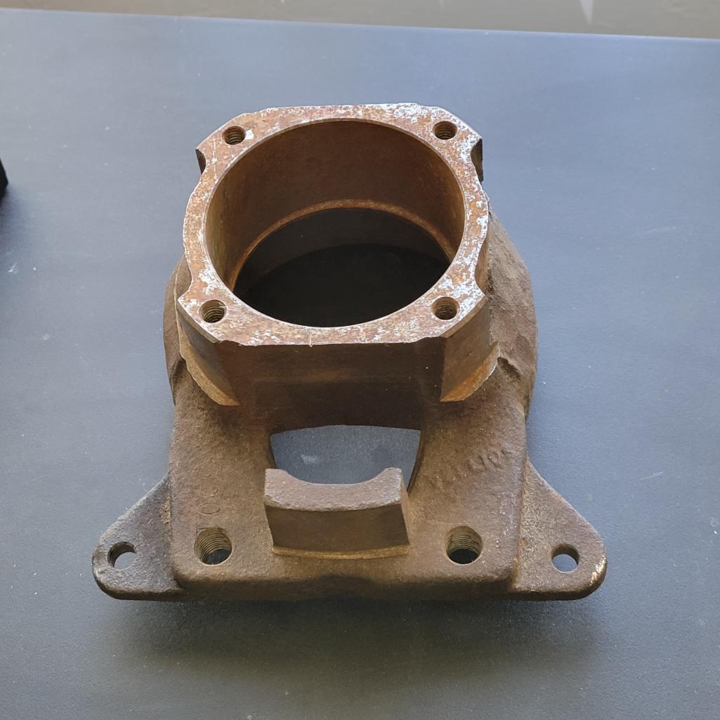

mepstein   Wilwood calipers are not an obvious choice on clas...   Apr 8 2026, 07:02 PM
Montreal914   3 or 3.5" front? Rear E-Brake with 911 inner...   Apr 9 2026, 08:07 AM
mepstein   3 or 3.5" front? Rear E-Brake with 911 inne...   Apr 9 2026, 09:04 AM
sixnotfour   These would come in Handy,, plus you get gbody 911...   Apr 9 2026, 02:07 PM
mepstein   These would come in Handy,, plus you get gbody 91...   Apr 9 2026, 04:17 PM
