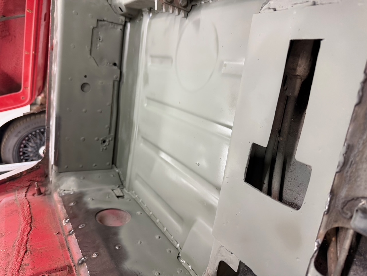

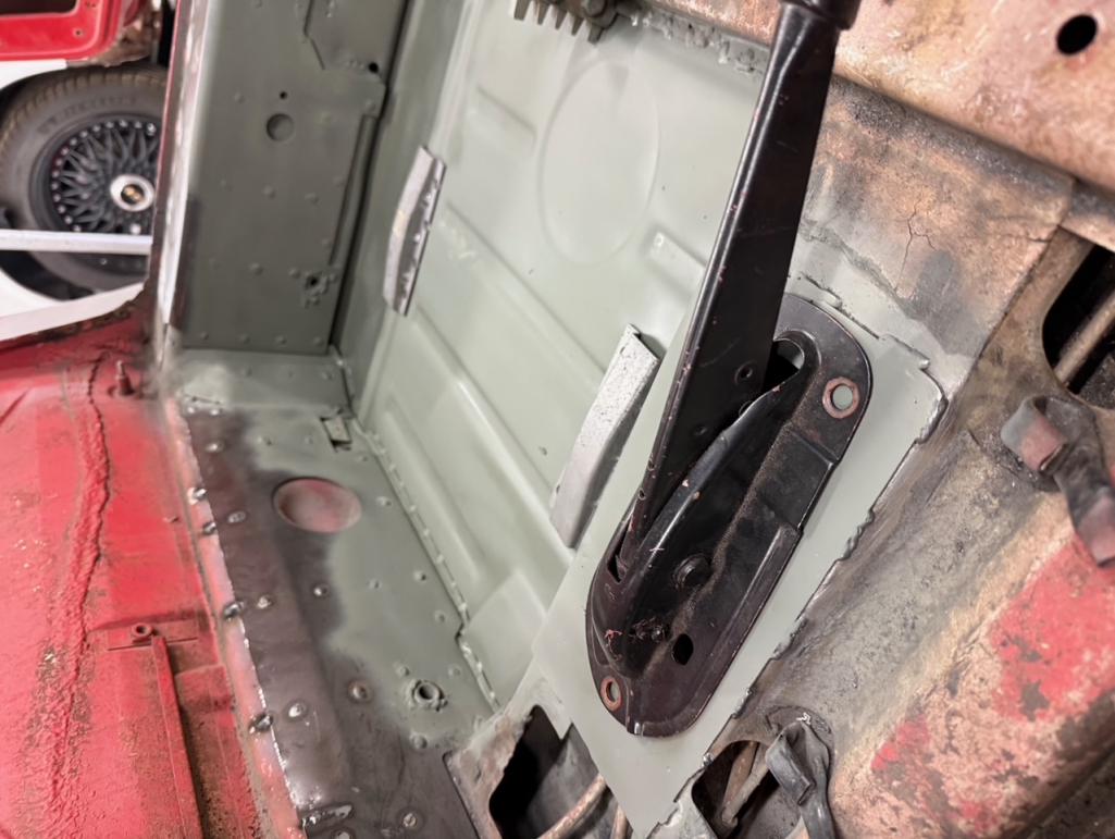

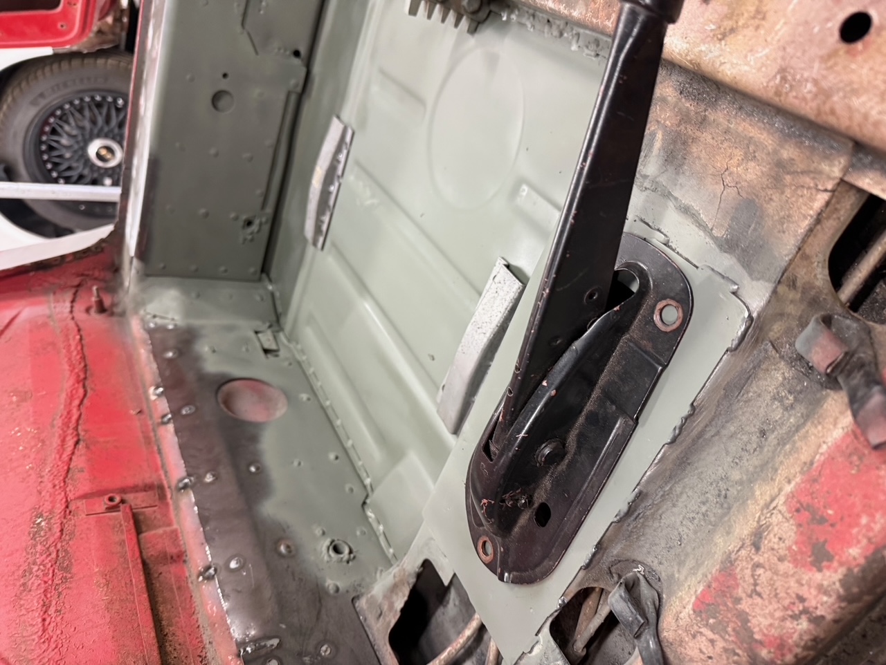

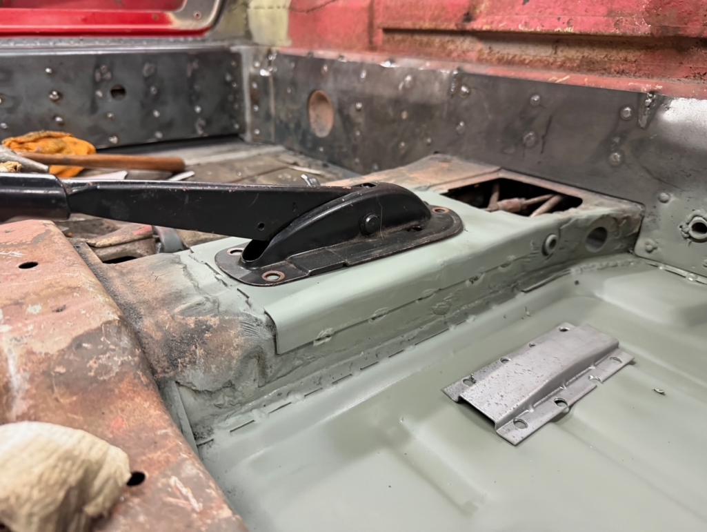

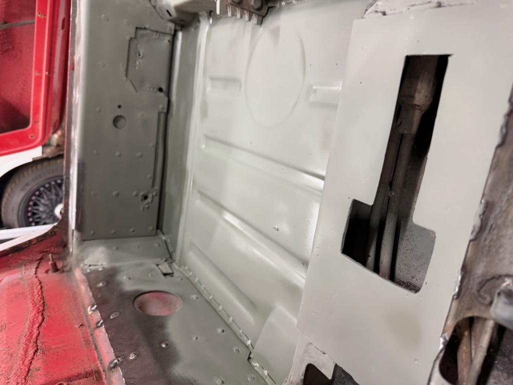

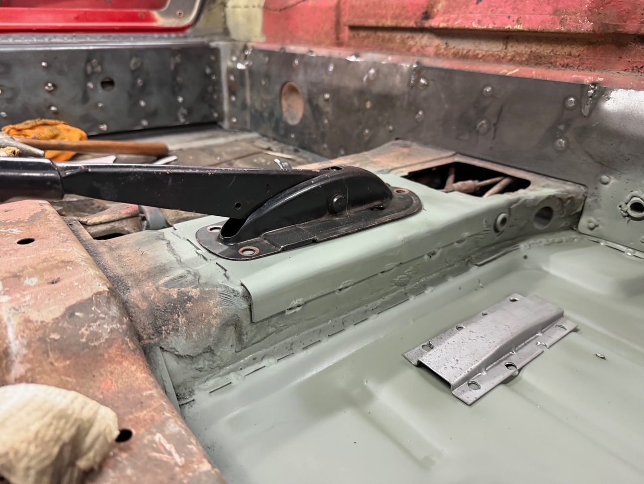

Jared is finishing up the e-brake install. He tried the factory GT position and I asked him to go further up the tunnel. He then added a reinforcement plate. I’m very happy with the result.
