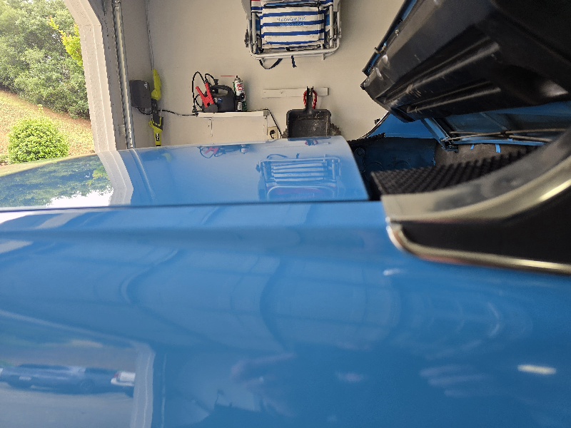

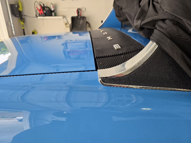

Today I was able to install the new engine tin seals, finish cleaning up the engine bay, intalled some of the bits and bobs, and button up adjusting the trunk and engine lid. Everything looks night and day different from when I purchased the car less than a year ago. Pretty happy I suppose.
With the JWest hinge installed and properly adjusted and that ridiculous spring wrestled back into place I was able to get the the trunk so that it sits flat with the fender.I also adjusted the engine lid up by adjusting the height of the hood latch hook and the hinges in/out a bit. Now it sits flush with the trunk, it was previously about 3/8 lower than the trunk and slightly askew.
