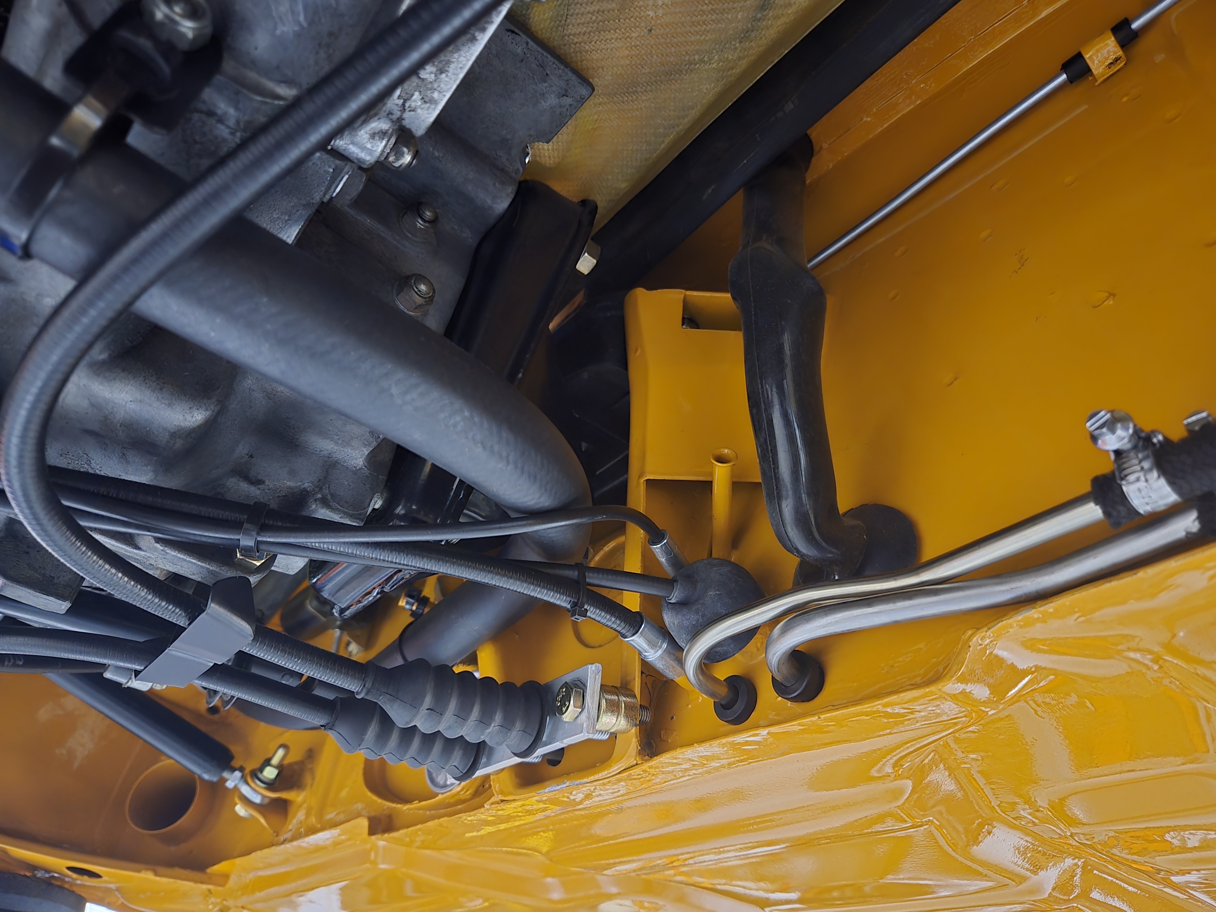

That is awesome to see a center tunnel 911 handbrake in the 914. No more brake lever in the crotch when exiting!
post Apr 12 2026, 09:05 AM
914-6 GT in waiting
Posts: 20,892
Joined: 19-September 09
Member No.: 10,825
QUOTE(tailwind22 @ Apr 12 2026, 10:28 AM) *
I'm not sure why it's not done more often. It's a pretty easy mod (realizing I'm not the one cutting and welding)

I like this mod. Can I pick your brain?
1. What e-brake handle assembly?
2. What Cables?
Matt

Well I sort of just did it without totally thinking through it but ...It's a SWB handle. I used it because I had an extra and it doesn't have heat levers. I haven't set up cables. I'm assuming I can use 911 cables but if not, custom cables can be made and they aren't very expensive. If the stock cables don't fit, at least I can measure from them. I'm using a Tangerine Racing brake kit to use 911 e-brakes.

You should be able to use 911 cables but will still need an adjustment method which is pretty simple. I did this, it works fine. Also note the little support to keep the cables off the headers.
