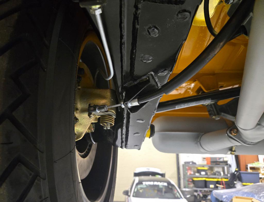

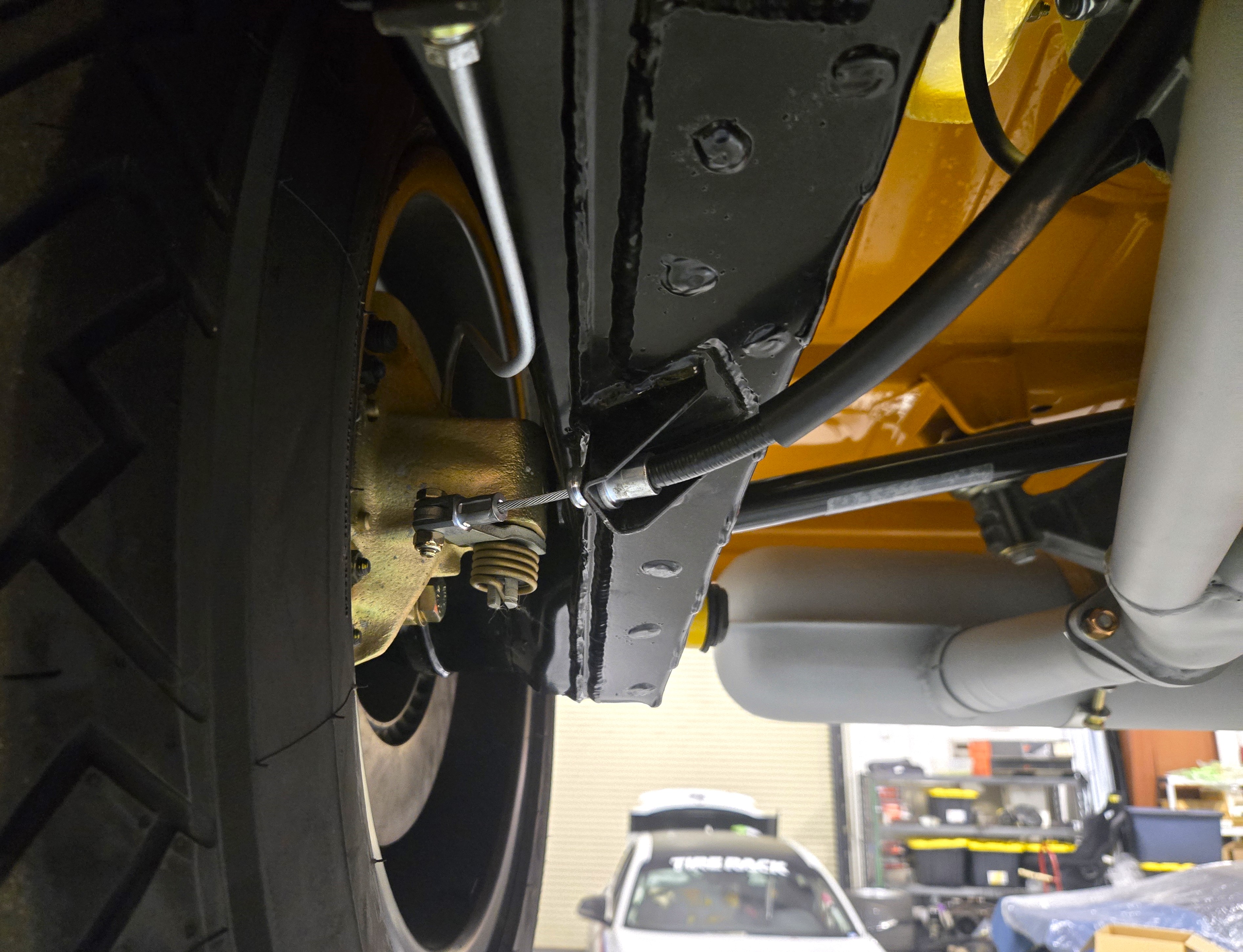

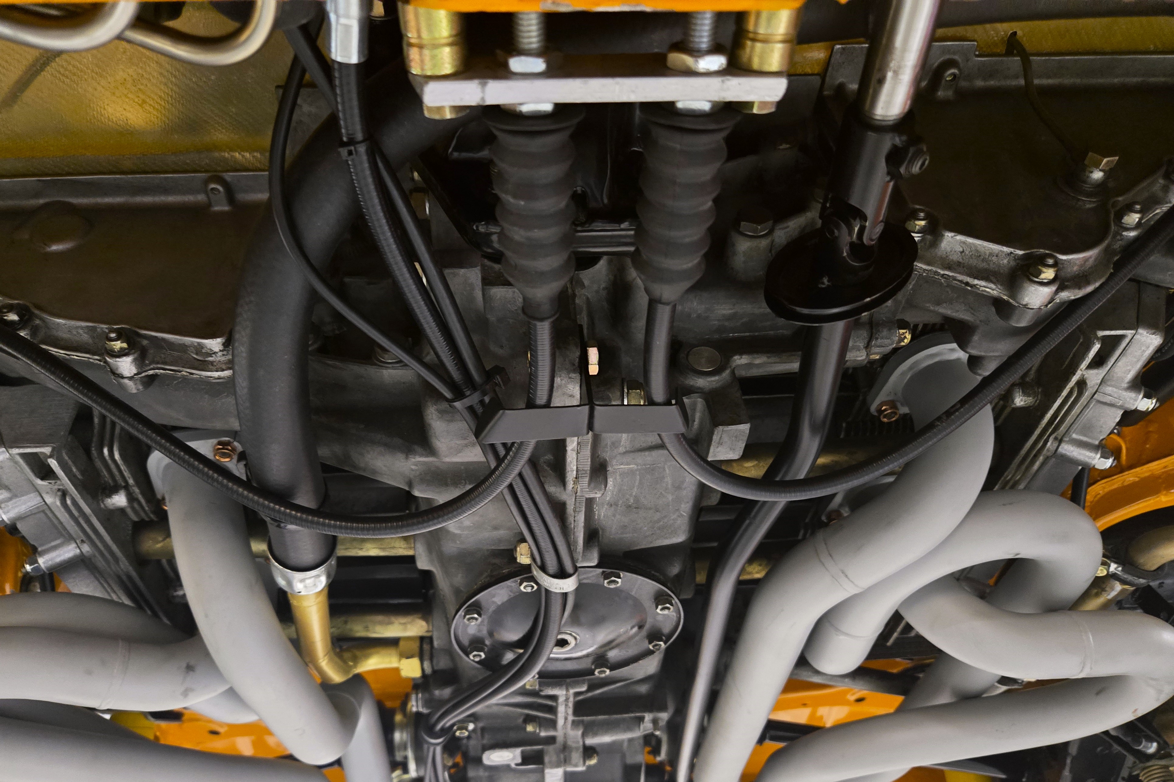

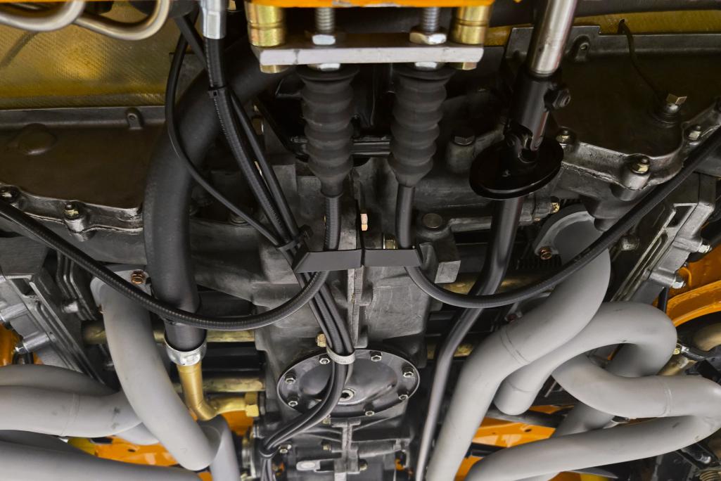

Happy to help... here's another detail shot, plus the calipers. These are stock 911 cables.

mepstein   Jared is finishing up the e-brake install. He trie...   Apr 11 2026, 06:40 PM
tailwind22   That is awesome to see a center tunnel 911 handbra...   Apr 12 2026, 08:28 AM
mepstein   That is awesome to see a center tunnel 911 handbr...   Apr 12 2026, 09:05 AM
mate914   That is awesome to see a center tunnel 911 handb...   Apr 12 2026, 09:14 AM
mepstein   [quote name='mepstein' post='3252960' date='Apr 1...   Apr 12 2026, 10:07 AM
Bullethead   [quote name='mepstein' post='3252960' date='Apr ...   Apr 12 2026, 02:03 PM
mepstein   Thanks for the pic :beer2: I had a feeling I wou...   Apr 12 2026, 03:07 PM
