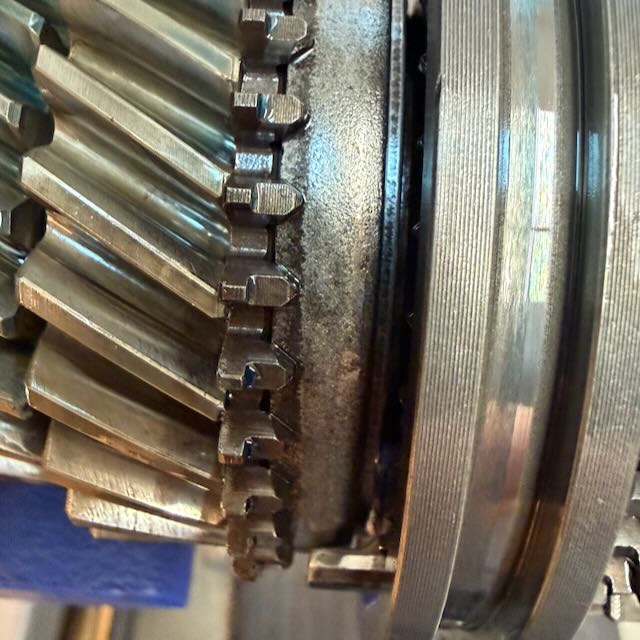

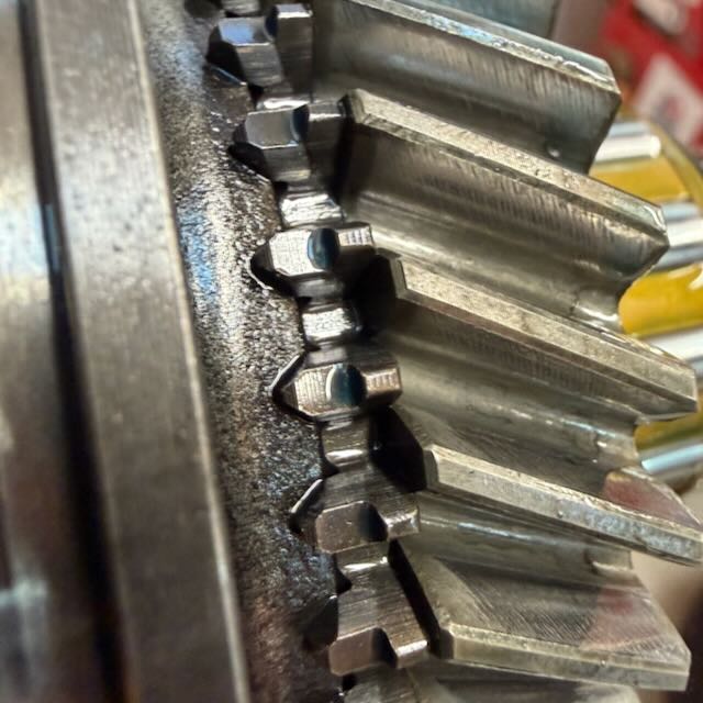

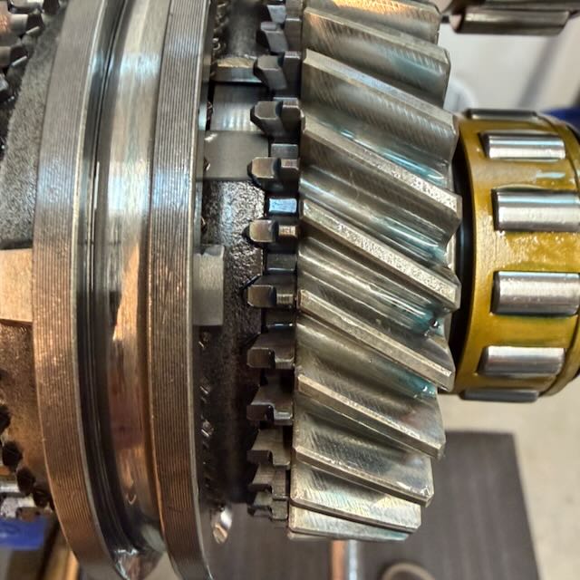

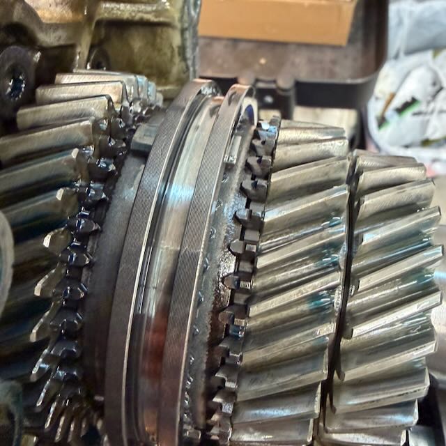

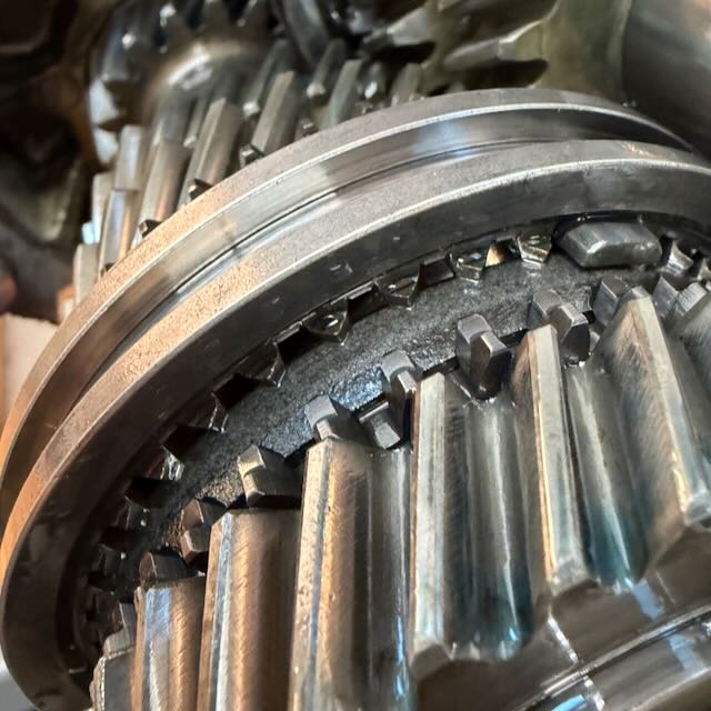

I pulled the stack today. The 3 dog teeth and slider teeth seem OK. 2 is a bit worn and may need a slider. 4/5 look great. All synchros have wear - will know more when it is broken down.
Maybe this is a candidate for the 2/3 to 4/5 swap of sliders ...

Chaznaster   I pulled the stack today. The 3 dog teeth and slid...   Apr 14 2026, 05:15 PM
