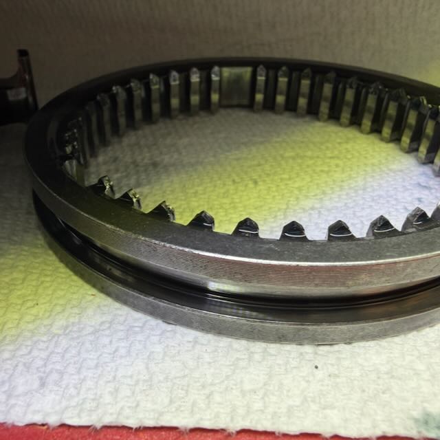

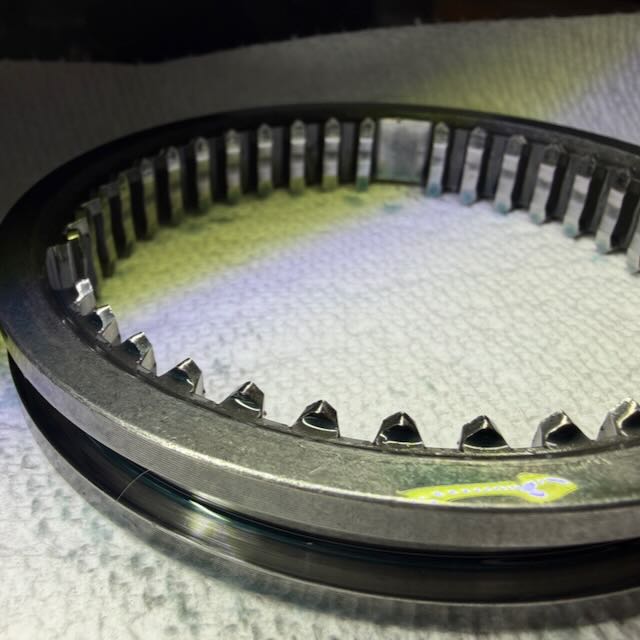

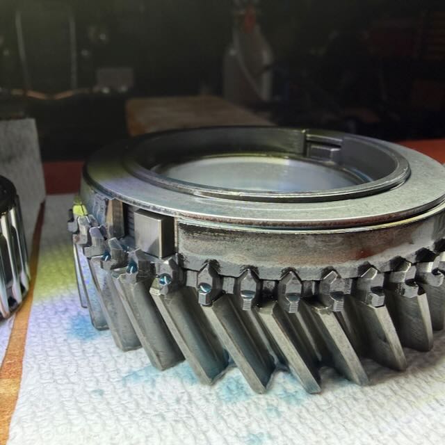

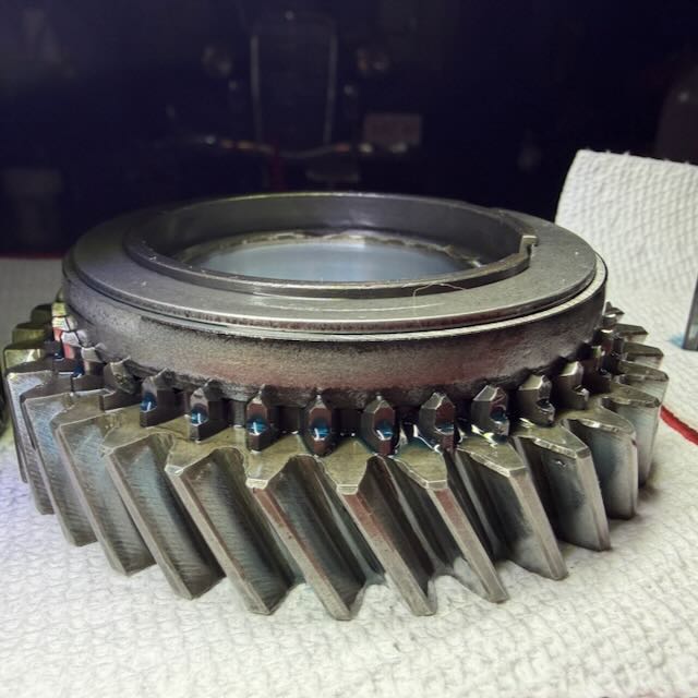

I got to some disassembly today and have questions ...
Based on the photos below:
1st pic - 2nd gear dog teeth ... these look good to me. Are they keepers?
2nd pic - 2nd gear side slider ... these look rounded. Not sure if they are candidates for a swap with 4/5 or totally shot.
3rd pic - 3rd gear dog teeth ... these look good to me, too.
4th pic - 3rd gear side slider ... these look pretty good but if the other side is shot so be it.
For 2 and 3 gear - would you replace those synchros? I would think at least the one on 2 as it has shiny bits.

Jack Standz   To answer your question: "For 2 and 3 gear ...   Apr 18 2026, 03:20 PM
