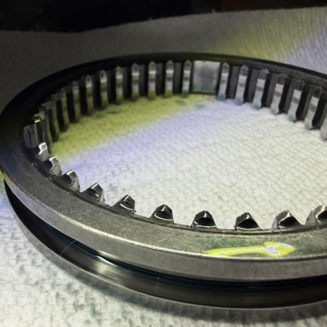

I got the rest disassembled this morning.
Synchros 2-4 are definitely worn (not symmetrical when viewing from the edge) and I will replace them. 5 looks fine.
I am going to replace the dogs on 2. They are probably passable but "while I am in there ..."
The only open question is whether to replace the 2/3 slider or swap with 4/5. The pic of the 2-side of the 2/3 is below. It is not as sharp as the others but does not seem too bad to me. What do you all think?
Thanks.
