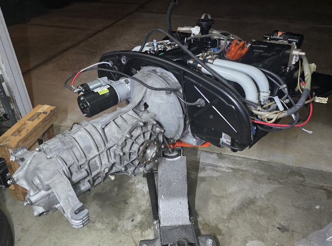

This escalated quickly! 1.8 is out, getting ready ready for the 2056 to go in.
I will start to clean up the engine bay and the underside of the car to prep for the new motor.]

Thanks for the info on the clamps and the kind words of encouragement.
Im waiting on a few hoses and then I will go over everything once more before I stab the motor back in. Pretty close at this point. Should be interesting to see if I got everything right. The L-Jet is incredibly simple to re-install with all of the great info available here! I just hope it starts!
Getting closer!
