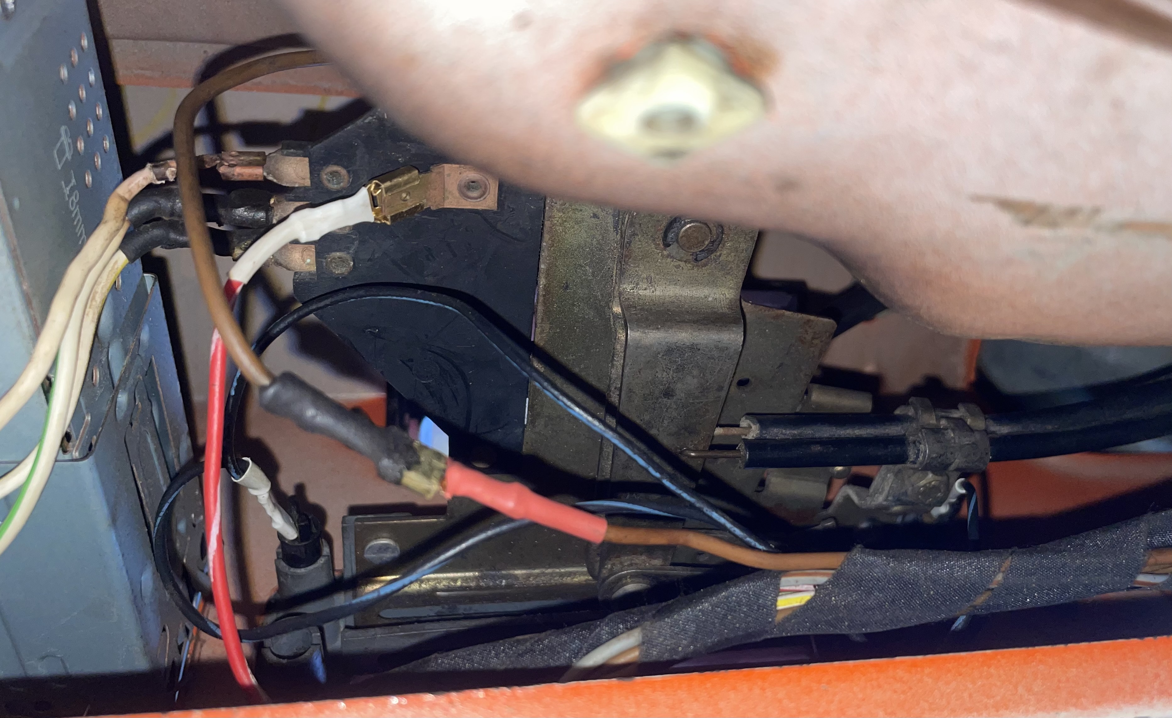

Wiring reconnected and put back into place.

Literati914   Wiring reconnected and put back into place.   Apr 22 2026, 01:28 PM
