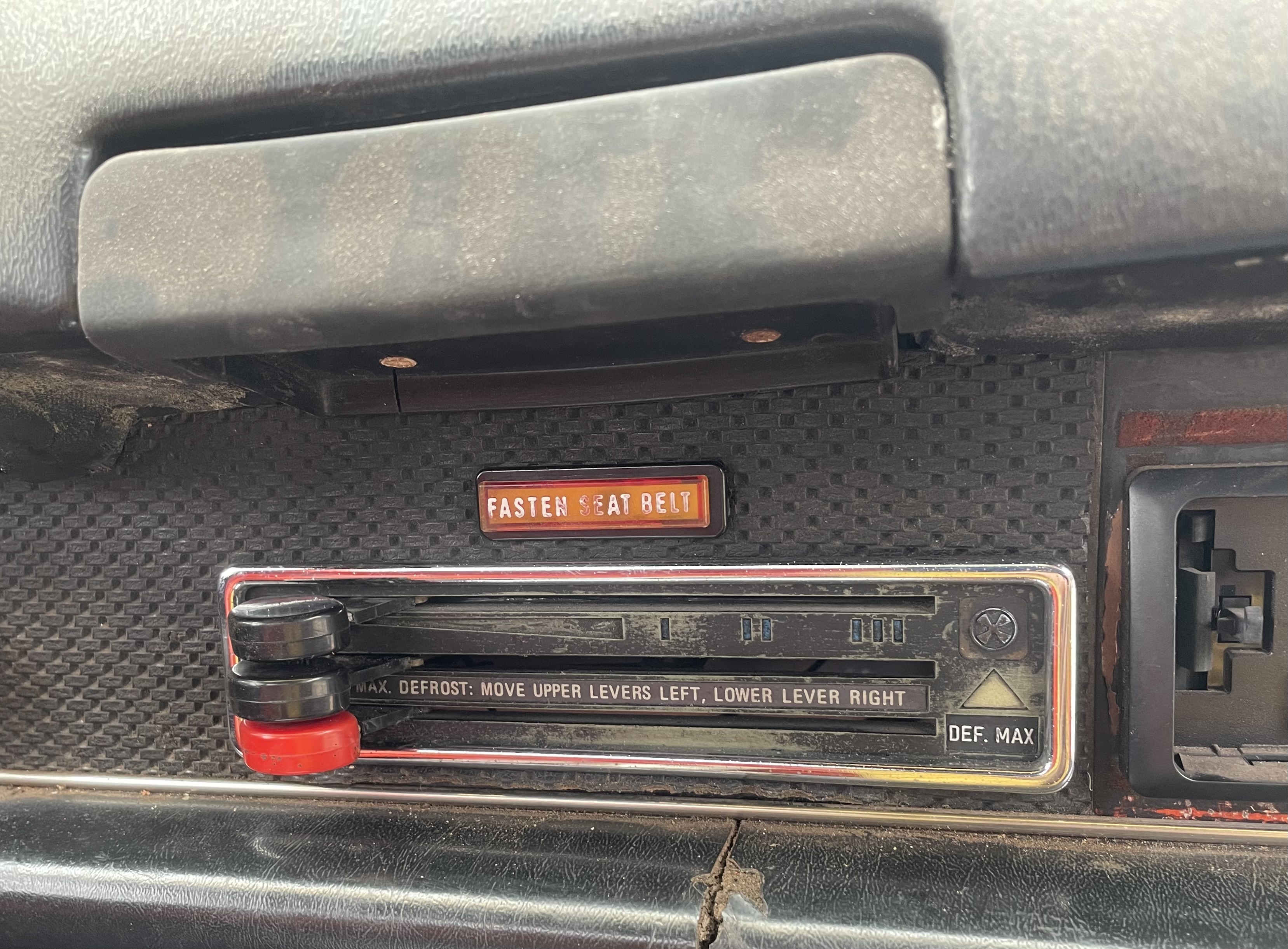

Literati914   Wiring reconnected and put back into place.   Apr 22 2026, 01:28 PM
Literati914   Slider unit and FSB light back in..   Apr 22 2026, 01:30 PM
Literati914   Great. Except after I went through removing the cu...   Apr 22 2026, 01:40 PM
Literati914   So then I got to do this (fun! :angry: )   Apr 22 2026, 01:41 PM
