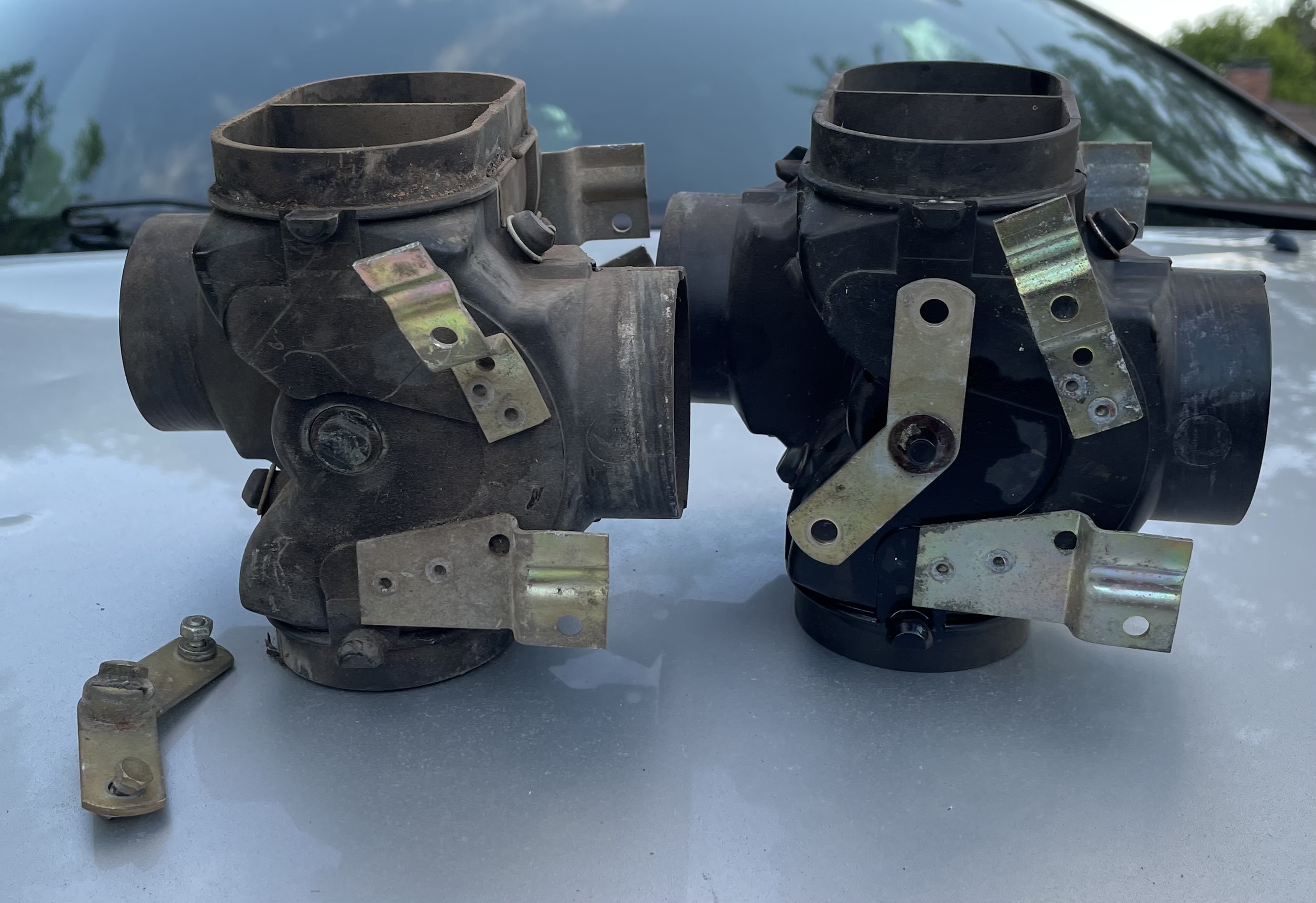

Great. Except after I went through removing the cut cables and reattaching the good ones from my good slider unit - the center slider would not move (IMG:style_emoticons/default/headbang.gif) . So I ended up breaking an arm on the driver’s side defrost unit, trying to free it.
Broken part and replacement

Literati914   I managed to get the defrost unit replaced, cables...   Apr 24 2026, 08:47 AM
