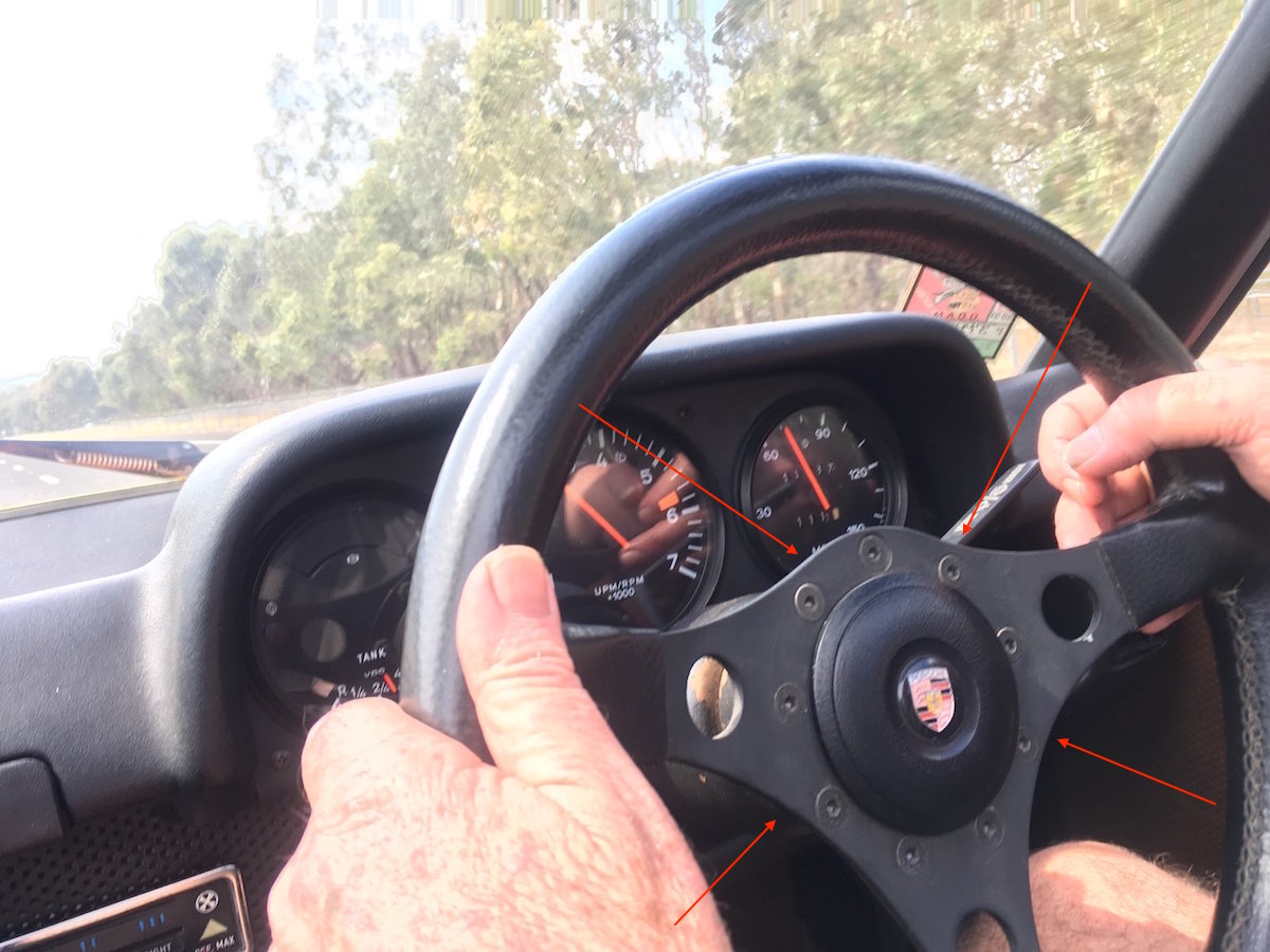

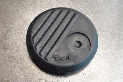

yeah that steering wheel is interesting if it is what i think it is.
at first look i think its a formuling wheel. a french company that made aftermarket sports steering wheels - very popular cult item during late 60s, 70s and into the 80s.
big in the VW modding crowd back then. company closed in the 90s.
reason i say its a formuling is they are recognizable by the spoke hub pattern around the centre boss. at top a curve matching circular steeing hub and at bottom two inverse curves to bottom wheel spoke.
this is mine. has been on the car since the 70s.
second reason is i am looking at what appears to be the brending name on it and its hard to tell from your photo as the brand name looks heavily worn or dirty and difficult to distinguish clearly.
but it sure looks like this? or am i mistaken.
at one point during formuling's time manufacturing the branding looked like this.
lastly its interesting because it also looks like it was branded porsche on one of its spokes. never seen one like that before. probably super rare. most formuling steering wheels were sold with a horn button that carried particular car model you were fitting it two. VW or Renault or Porsche---- whatever.
definitely keep that wheel and restore it. suspect its been on the car for a long time.
i can't identify which era it dates from. could be 70s. could be 80s. suspect its 70s.
and i think pretty rare formuling model.
cult item. VW crowd is still searching these things out.
