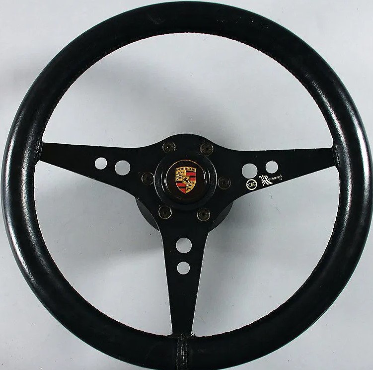

QUOTE(wonkipop @ Apr 22 2026, 03:23 PM) *
yeah that steering wheel is interesting if it is what i think it is.
at first look i think its a formuling wheel. a french company that made aftermarket sports steering wheels - very popular cult item during late 60s, 70s and into the 80s.
big in the VW modding crowd back then. company closed in the 90s.
reason i say its a formuling is they are recognizable by the spoke hub pattern around the centre boss. at top a curve matching circular steeing hub and at bottom two inverse curves to bottom wheel spoke.
this is mine. has been on the car since the 70s.
I think the steering wheel may be a Racemark.. Raid model specific to Porsche. I think someone has spray painted a super dark iridescent bronze color over the spokes area (btw, the plastic headlight surrounds have this too, and it's flaking off there too).
There is a recess on the spoke with the word "PORSCHE" inside of it.. but it kind of looks like the letters are small vinyl decal and may be de-laminating also. I have not found this exact wheel on google. but here s a very close example (note - that the ends of the spokes are not upholstered, they just dissapear into the outer part of the wheel)
