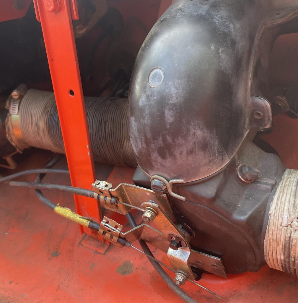

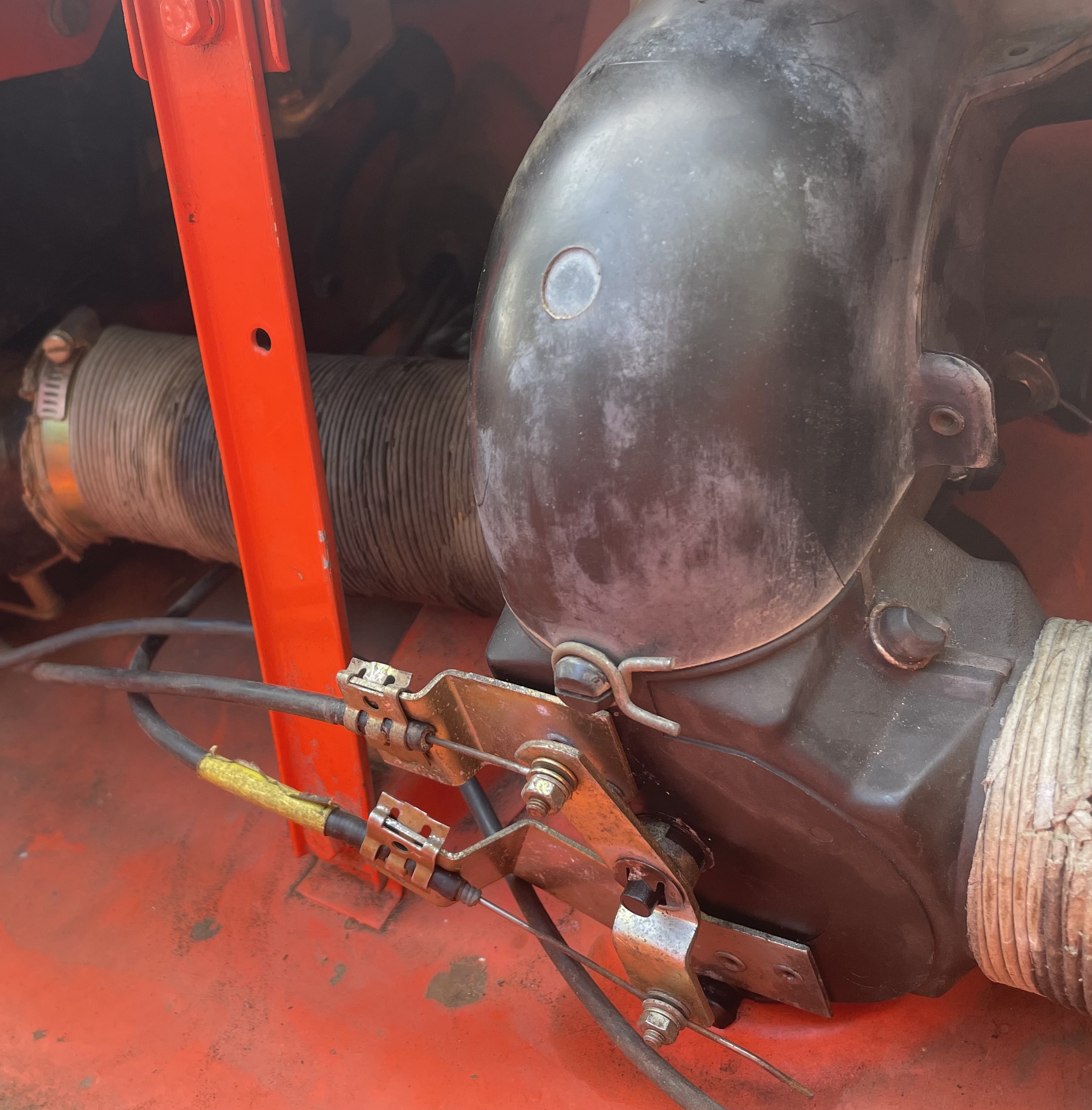

I managed to get the defrost unit replaced, cables re-run and sliders working

Literati914   I managed to get the defrost unit replaced, cables...   Apr 24 2026, 08:47 AM
