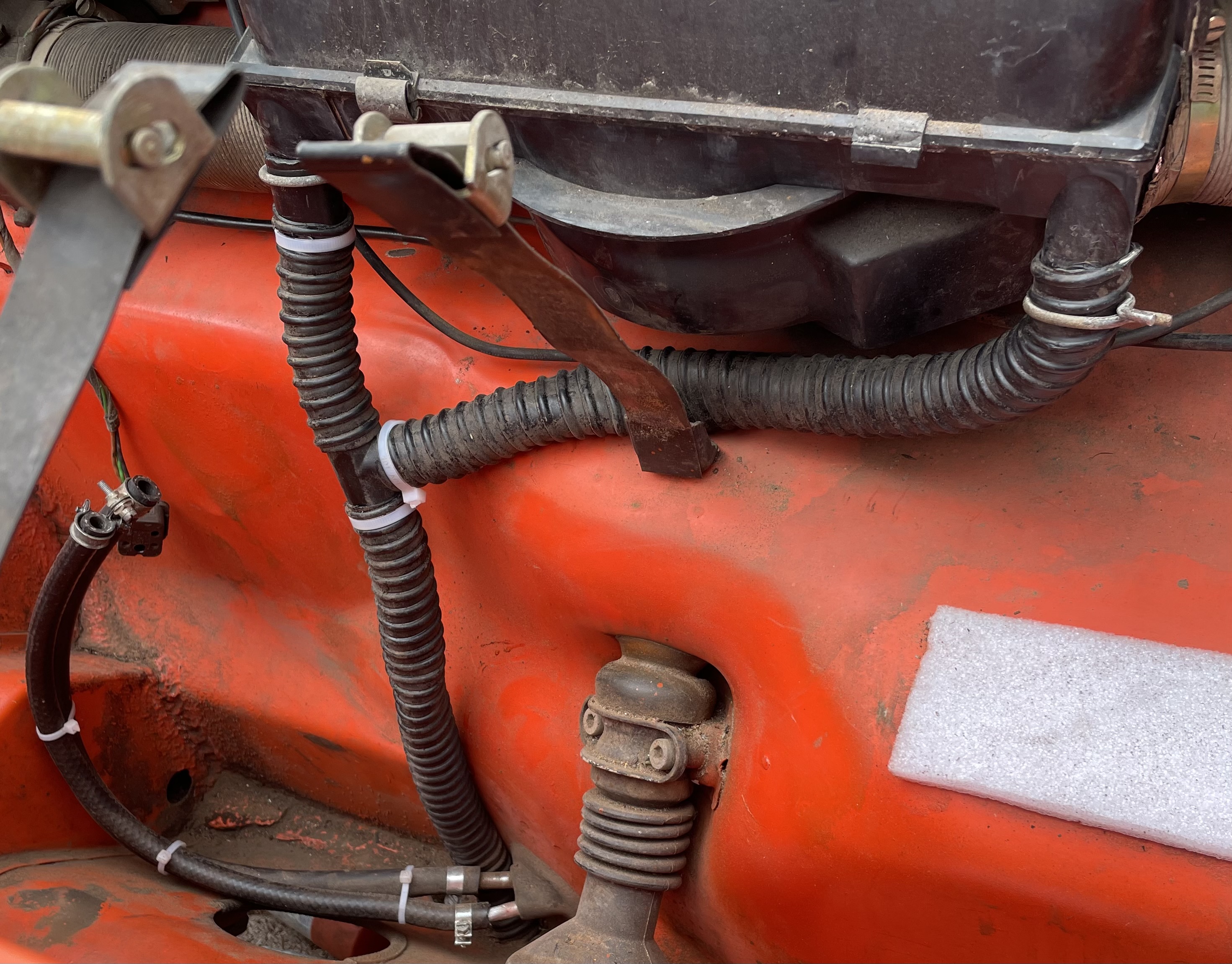

Literati914   Both the areas by the headlight motors looked like...   Apr 24 2026, 05:44 PM
Literati914   So I cleaned these areas up and probably avoided a...   Apr 24 2026, 05:46 PM
Literati914   Other side :D   Apr 24 2026, 05:47 PM
