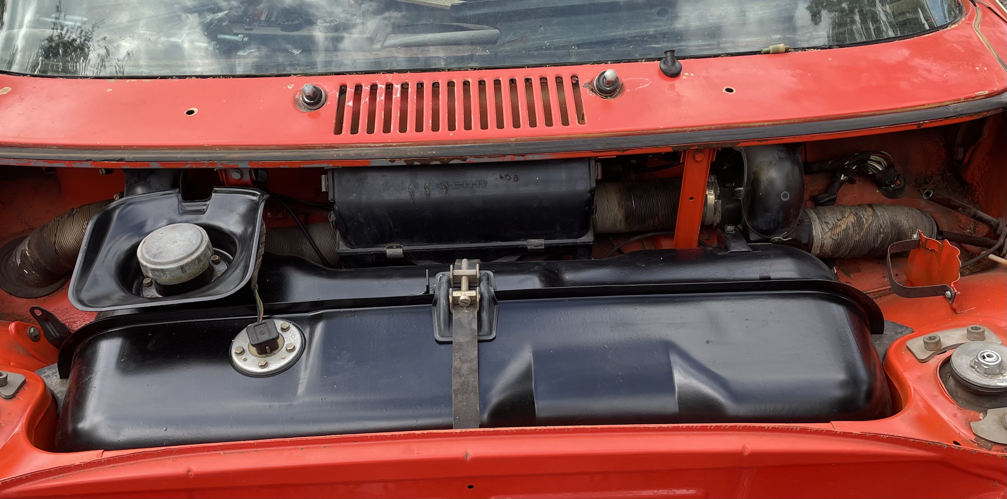

Literati914   Time to re-install the fuel tank… not so fast, b...   Apr 24 2026, 08:51 AM
Literati914   Tank back in.   Apr 24 2026, 08:52 AM
