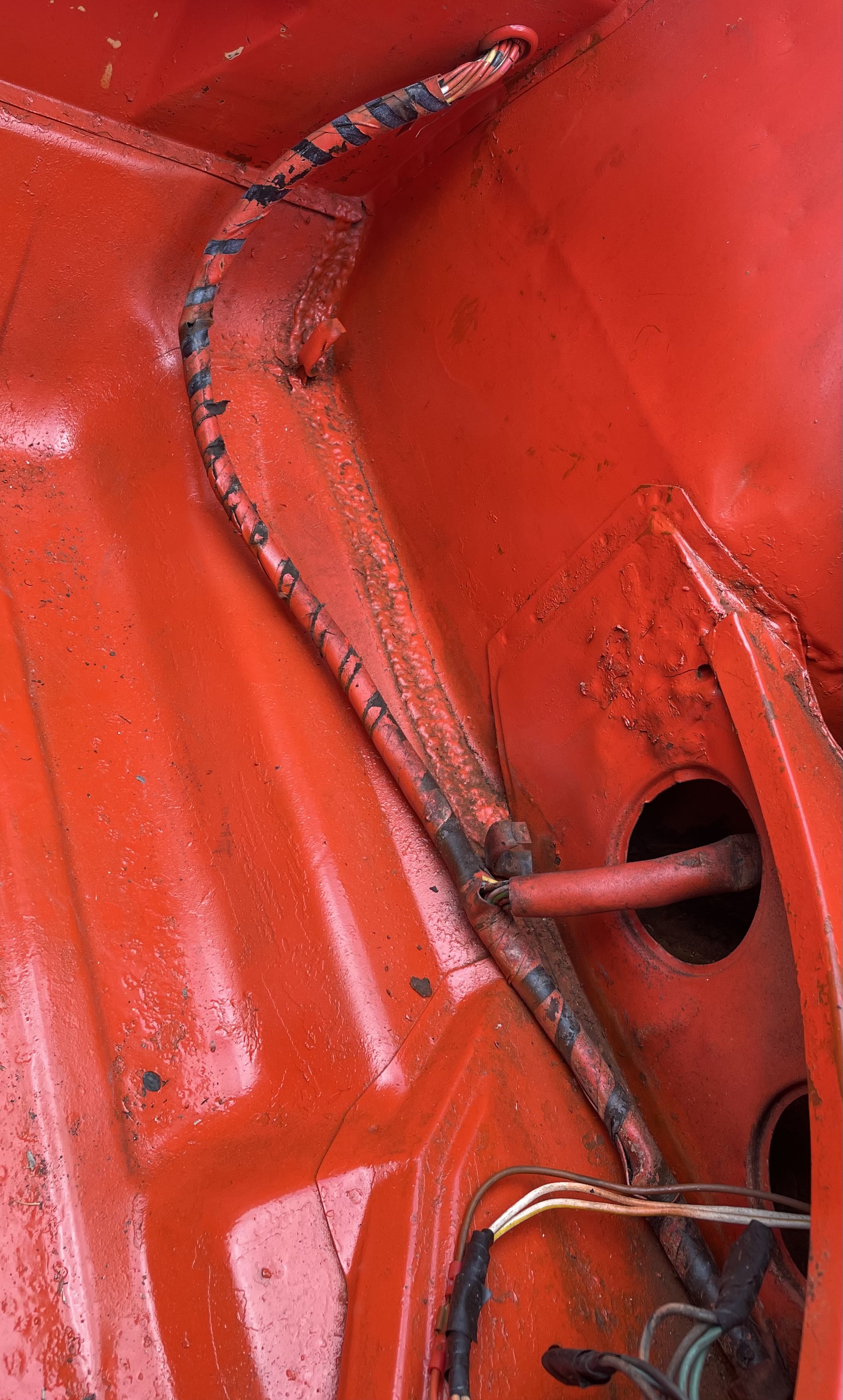

The harness in the frunk was bothering me with all it’s overspray..

Literati914   The harness in the frunk was bothering me with all...   Apr 24 2026, 08:53 AM
Literati914   So I cleaned it up and re-taped it. Ps - note in ...   Apr 24 2026, 08:58 AM
