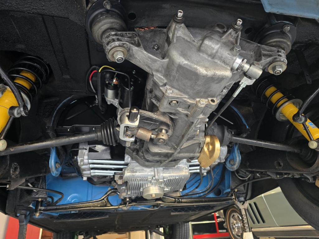

Updates! We got updates! So today I wrapped up a bunch of little ods and ends and then I figured it was time to put the motor back in.
Taking it slowly and double checking everything along the way.
To do list:
Weld on the afr bung
Mount setrab oil cooler
Get 15x6 Fuchs back from restoration
Install fan, fan shroud
Get 15" tires & install
Adjust right trunk hinge to fix uneven gaps
Repaint engine grills on engine cover
install new P O R S C H E letters on engine cover
Get new battery and install
Finish MC install and bleed brakes
Break in the cam (will break it in with carbs)
Get harnesses back from El Jeffe
Install alternator
Install all the powder coated tins & gaskets
Set thermostat cable/flaps
Reassemble the ljet
Figure out how to adapt and install the GoWesty throttle body
Figure out how install A123 Distributor
Fill Transmission with fluid
Install circuit board and heater blower
Install Motor
Up next
Install exhaust & heat parts
Get motor running in the car
Wire up fan controller for oil cooler
Wire up the afr sensor
Wire up the cht sender & gauge
Install new combo gauge

QUOTE(TRP @ Apr 25 2026, 03:30 PM) *
To do list:
Install alternator
Reassemble the ljet
Install Motor
Up next
Nice work and very tidy ,don't forget the large cup washers that go between the gearbox mounting ears and the rubber mounts ok .
Keep up the good work and enjoying this build ,cheers Dean.
