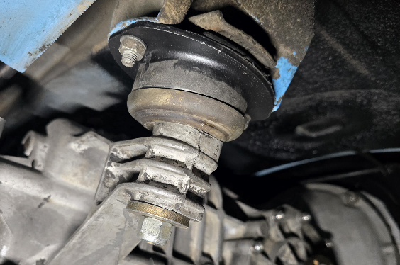

Thank you, I'm trying not to rush it.
I appreciate the extra eyes on the reassembly. Regarding the cup washers, do you mean these guys?:
I checked and they are on there, they just arent gold coated anymore. (IMG:style_emoticons/default/sad.gif)
