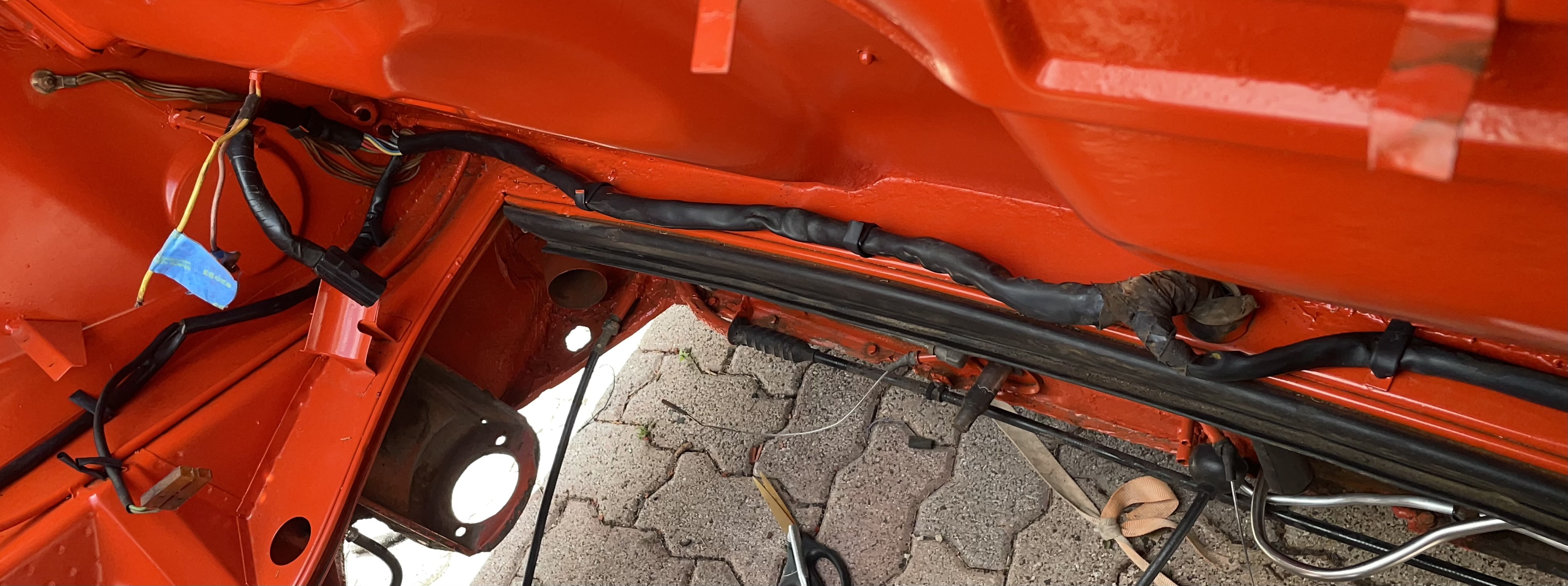

Moved to the back and cleaned up and installed the wiring harness at the engine compartment

Literati914   Moved to the back and cleaned up and installed the...   Apr 25 2026, 12:38 PM
Literati914   The right side   Apr 25 2026, 12:40 PM
Literati914   Wires going back to the trunk were in a sorry stat...   Apr 25 2026, 12:43 PM
Literati914   Cleaned up, re-taped.. and now reinstalled   Apr 25 2026, 12:44 PM
