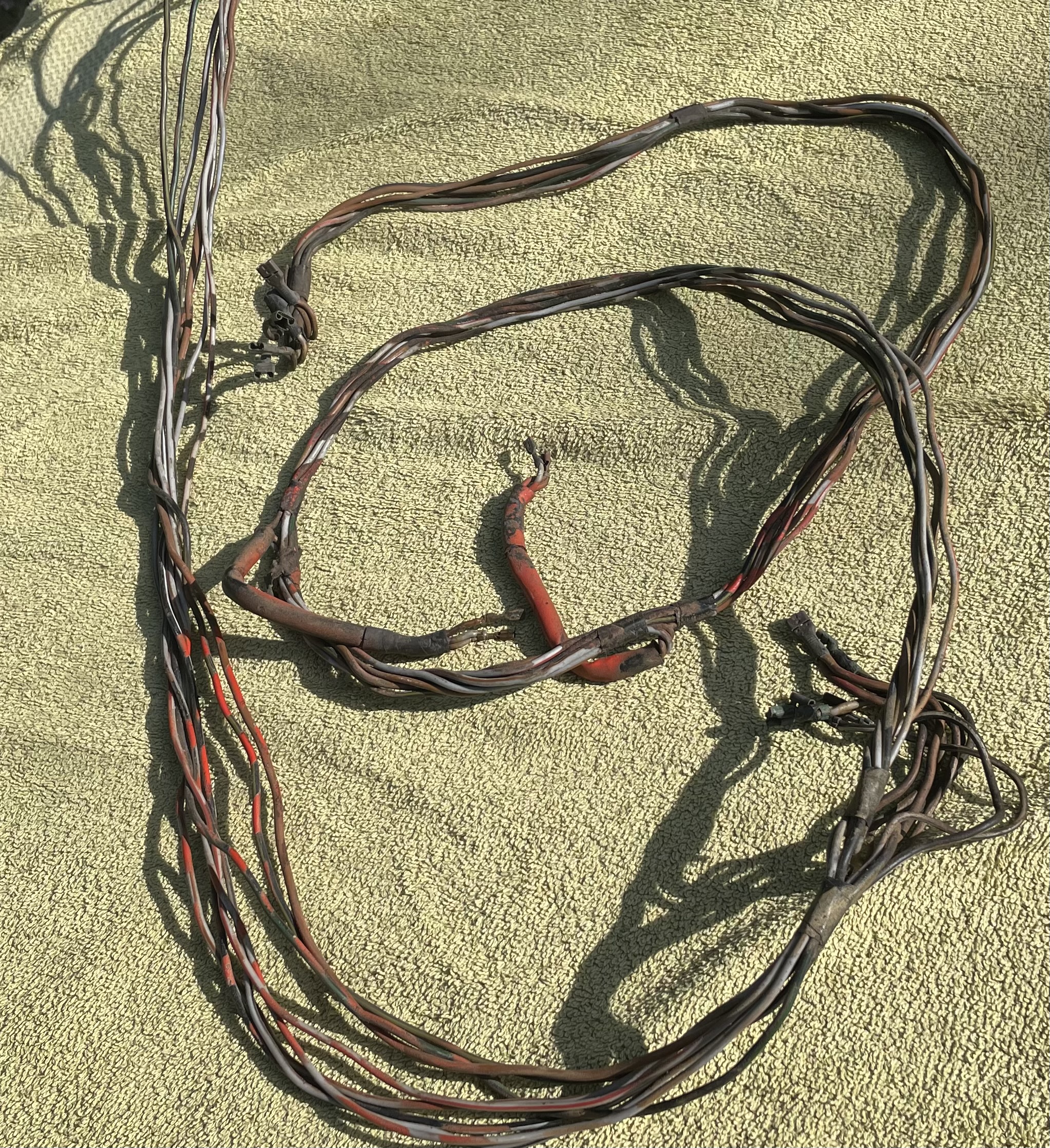

Literati914   Wires going back to the trunk were in a sorry stat...   Apr 25 2026, 12:43 PM
Literati914   Cleaned up, re-taped.. and now reinstalled   Apr 25 2026, 12:44 PM
