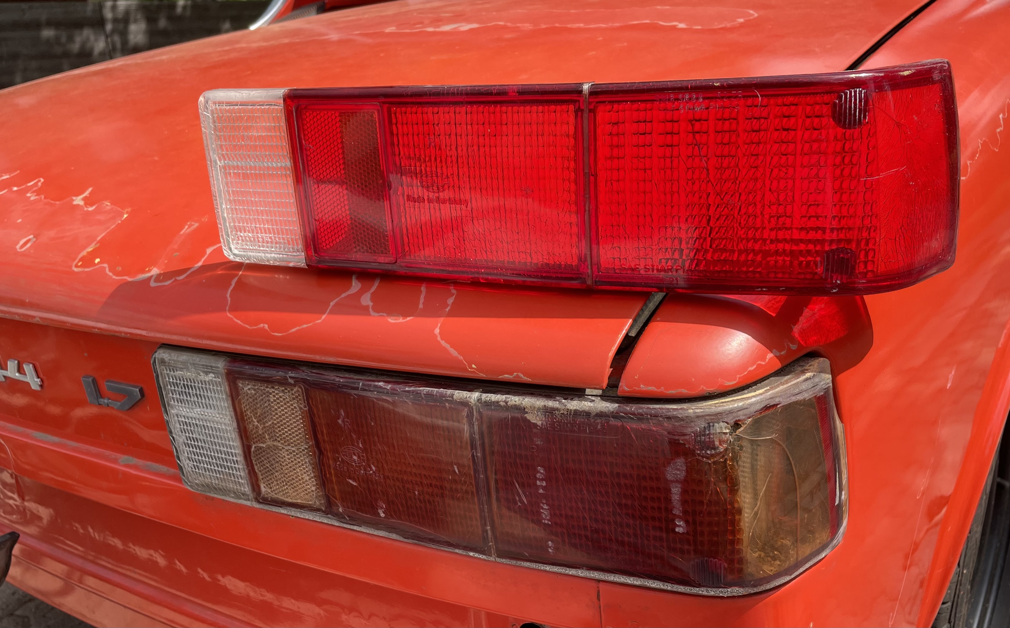

Which leads me to tail lights. The right side tail light lens on this car looked terrible, very washed out and oddly more transluscent on the outer curved section than normal. I snagged a better one for the car, a used Hella lens.

Literati914   Which leads me to tail lights. The right side tail...   Apr 27 2026, 07:31 PM
Literati914   The thin seals around the lenses were both deterio...   Apr 27 2026, 07:33 PM
