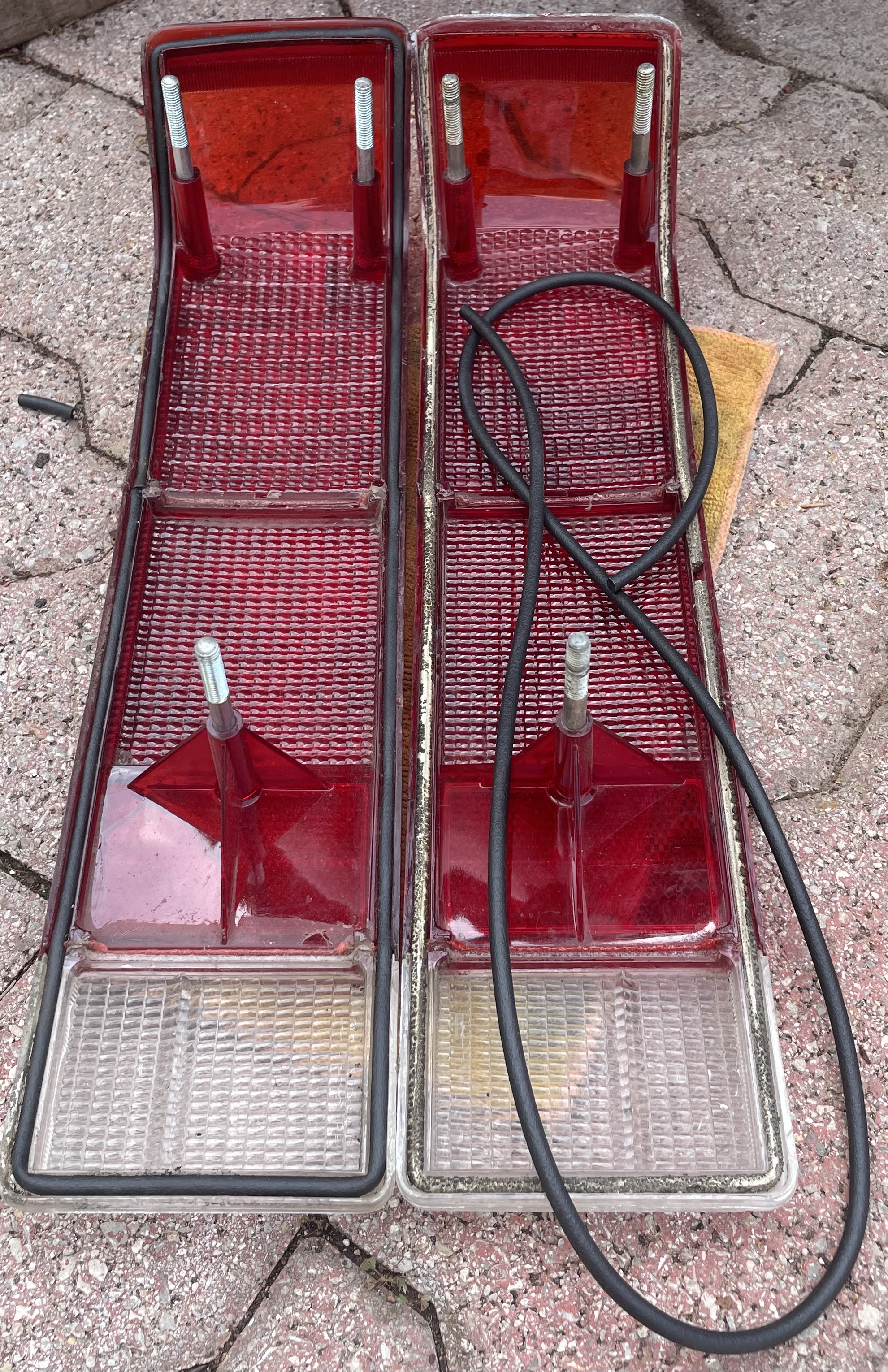

The thin seals around the lenses were both deteriorated so I replaced them before re-install

Literati914   Which leads me to tail lights. The right side tail...   Apr 27 2026, 07:31 PM
Literati914   The thin seals around the lenses were both deterio...   Apr 27 2026, 07:33 PM
