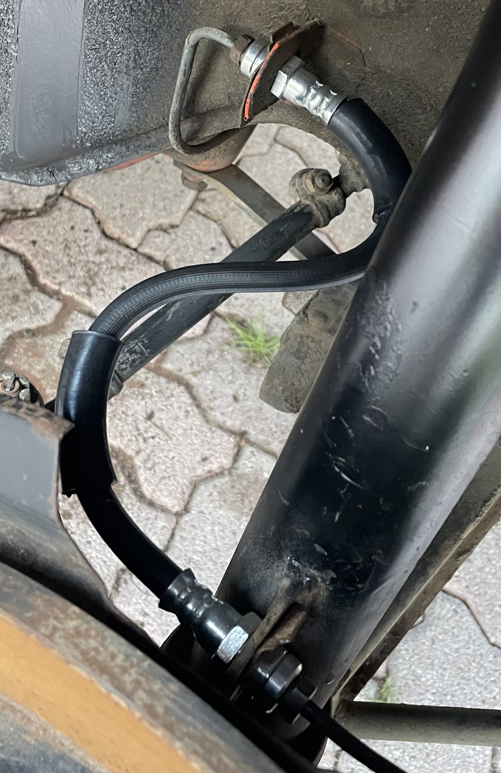

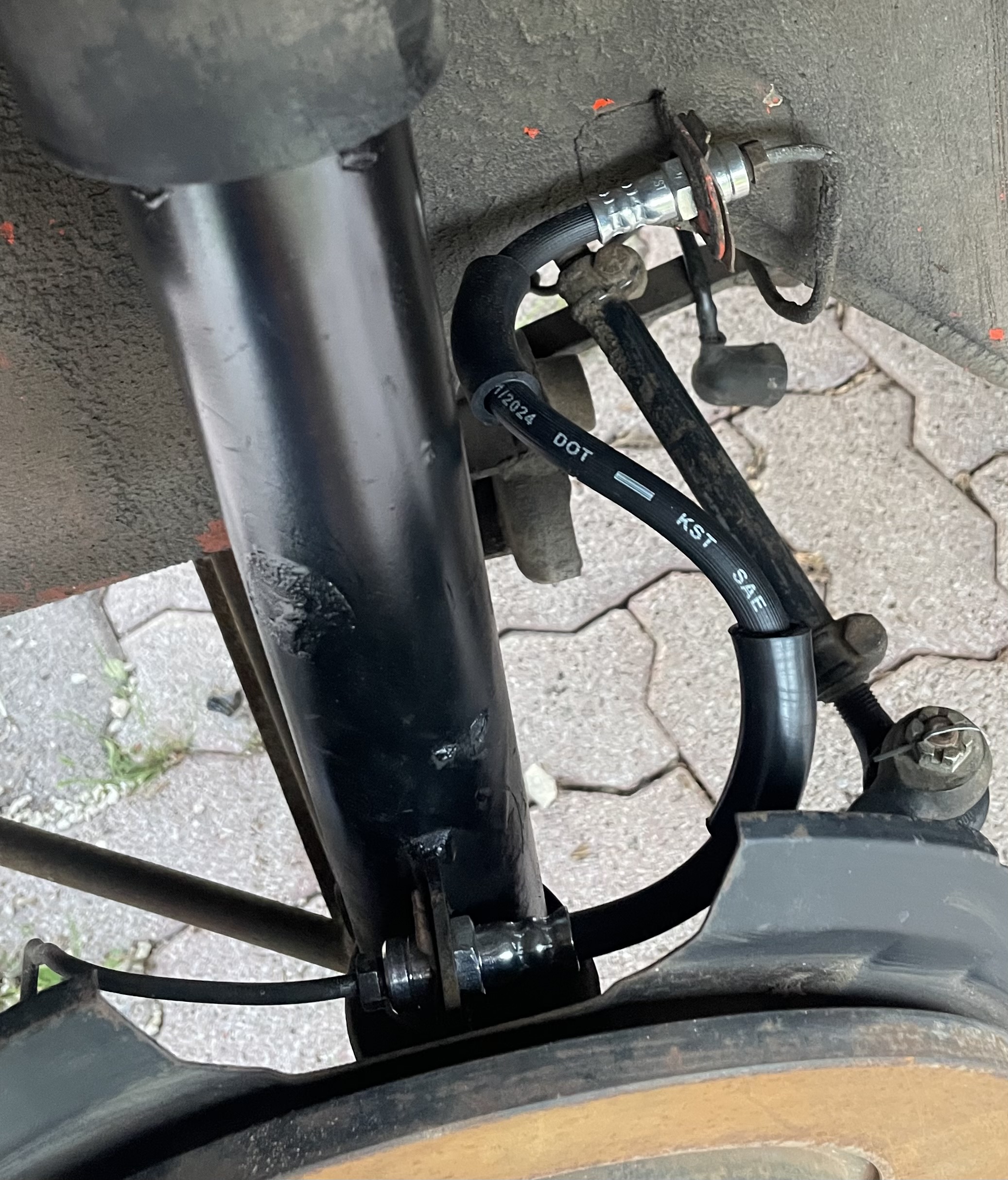

Jumped up to the front and cleaned up the suspension assembly a little - shot a little paint on them sad looking strut housing. But more importantly I got new rubber brake hoses installed on both sides:
