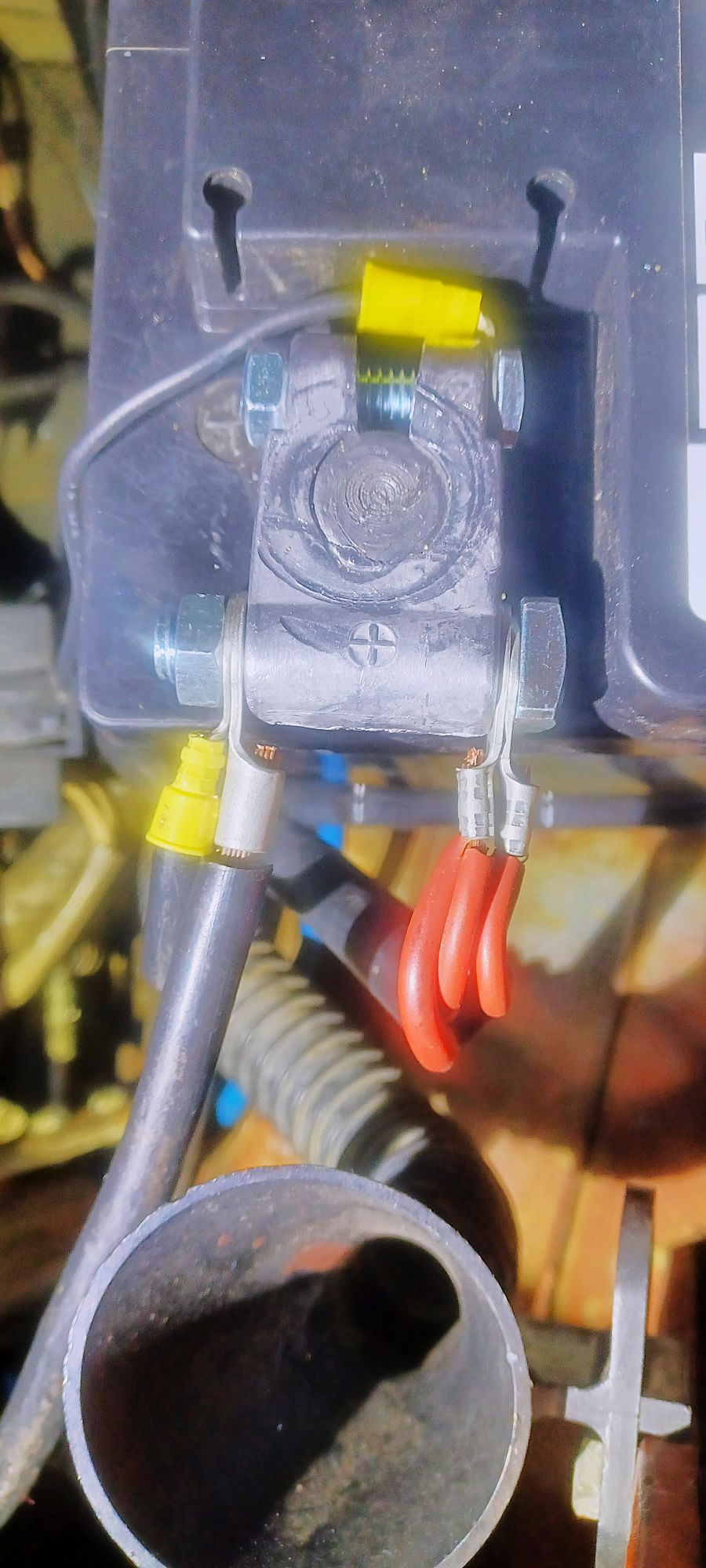

I have a sloppy DAPO red positive wires and cheapo aftermarket positive battery terminal situation and would appreciate best solution to tidy these up, make better connections, etc.
This also makes me curious about how 4-6 wires were originally run to the positive battery terminal from the factory.

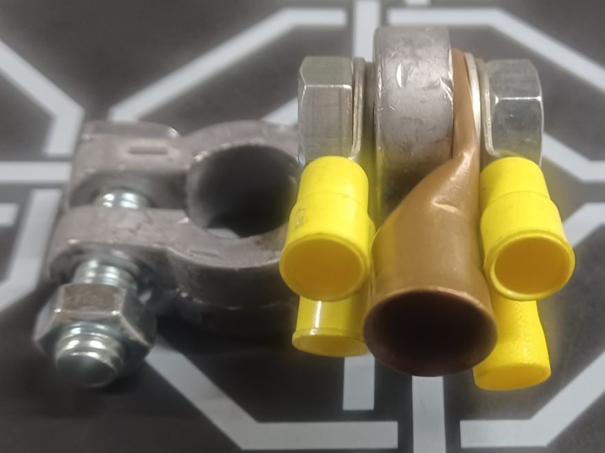

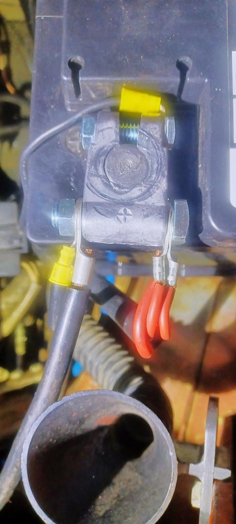

Here's what I was going to do, until I figured out it wouldn't clear the rain tray... (IMG:style_emoticons/default/headbang.gif)
Here's what I ended up doing...
Both types of battery terminals were sourced from Wally World. The last one is their "Heavy Duty" battery terminal pair, about $8 IIRC for both + and -. The non-insulated ring terminals came from a local Ace Hardware store.
I was able to squeeze two positive leads in each of those 2 ring terminals MOL like the factory did. I have a decent ratcheting crimp tool to squish them with, which helped.
The extra lead not on the larger terminal bolt is power for the rear trunk solenoid. I'm planning on moving it to another 12v power source later.
