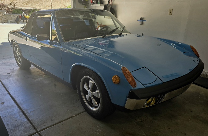

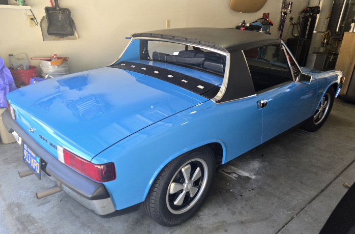

I buttoned up rerouting the oil lines, wired up the cooler cooling fan, and the install of the AFR and CHT gauges today. All three items work well. Tomorrow I will install the multi-gauge with the oil temp gauge and try to figure out why I cant get it to idle. The biggest update is that the car is back on the ground for the first time since November. I haven't even rolled it forward or backwards at this point, just fresh off the jacks after 6 months.
