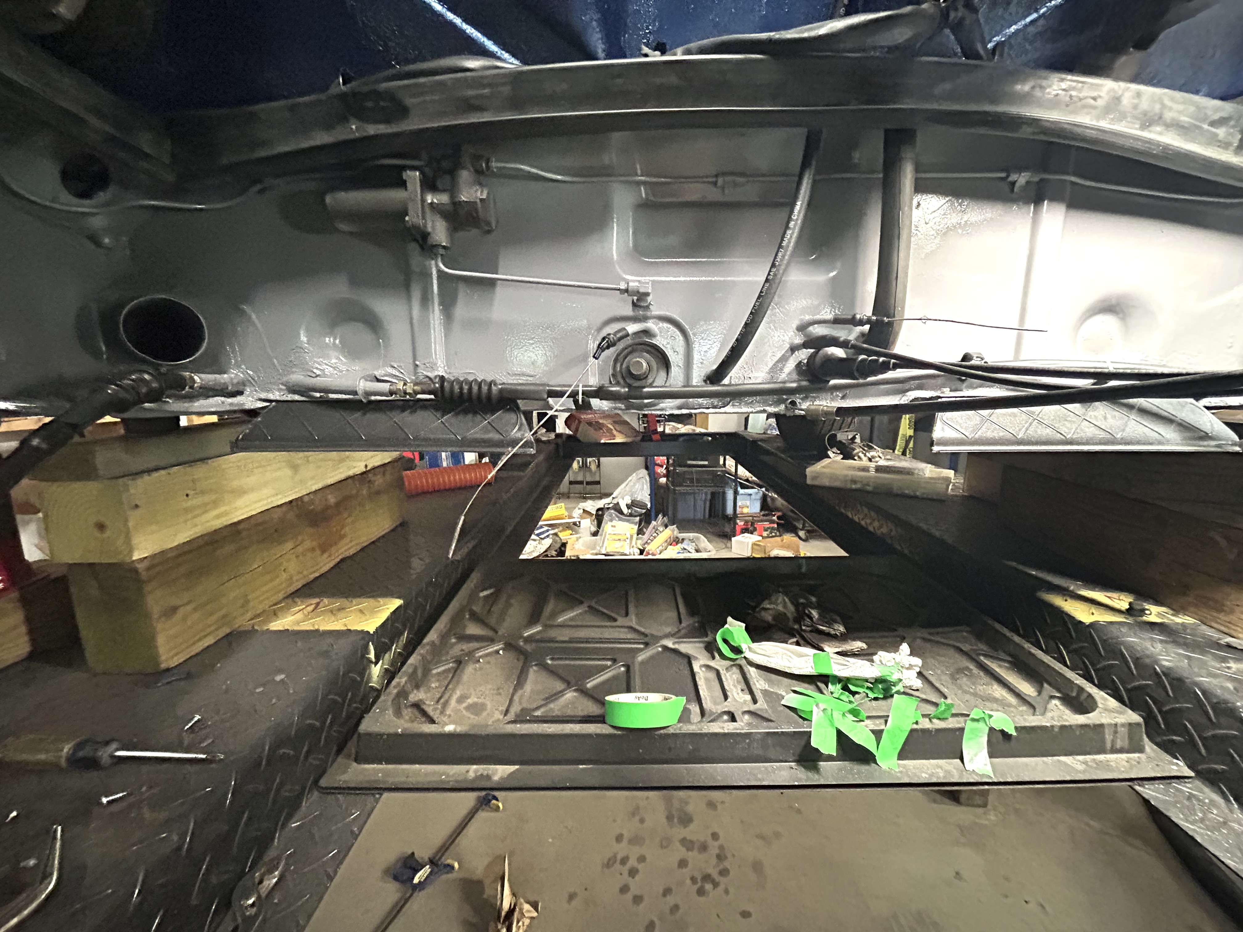

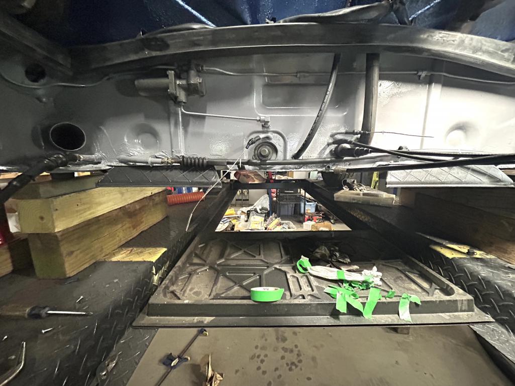

HFC3   Last of the engine compartment repairs.   May 17 2026, 02:02 PM
