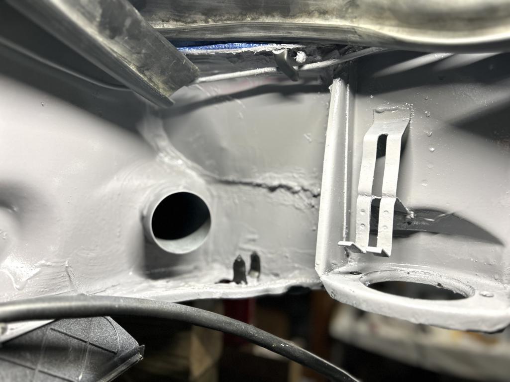

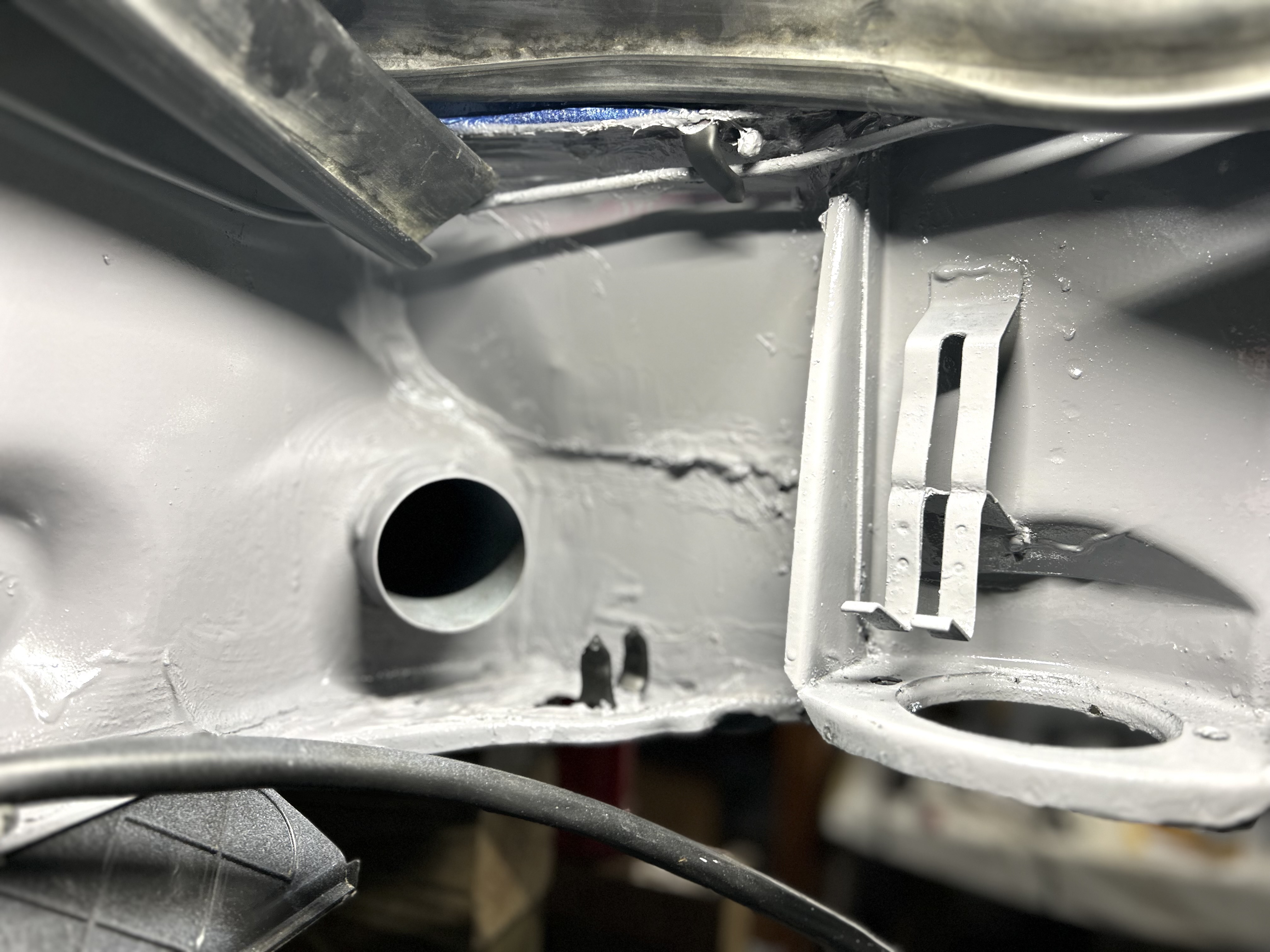

HFC3   Last of the engine compartment repairs.   May 17 2026, 02:02 PM
HFC3   Replaced a section I had already repaired. Fit w...   May 17 2026, 02:04 PM
