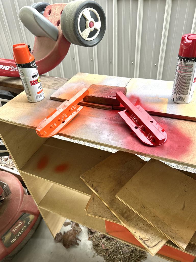

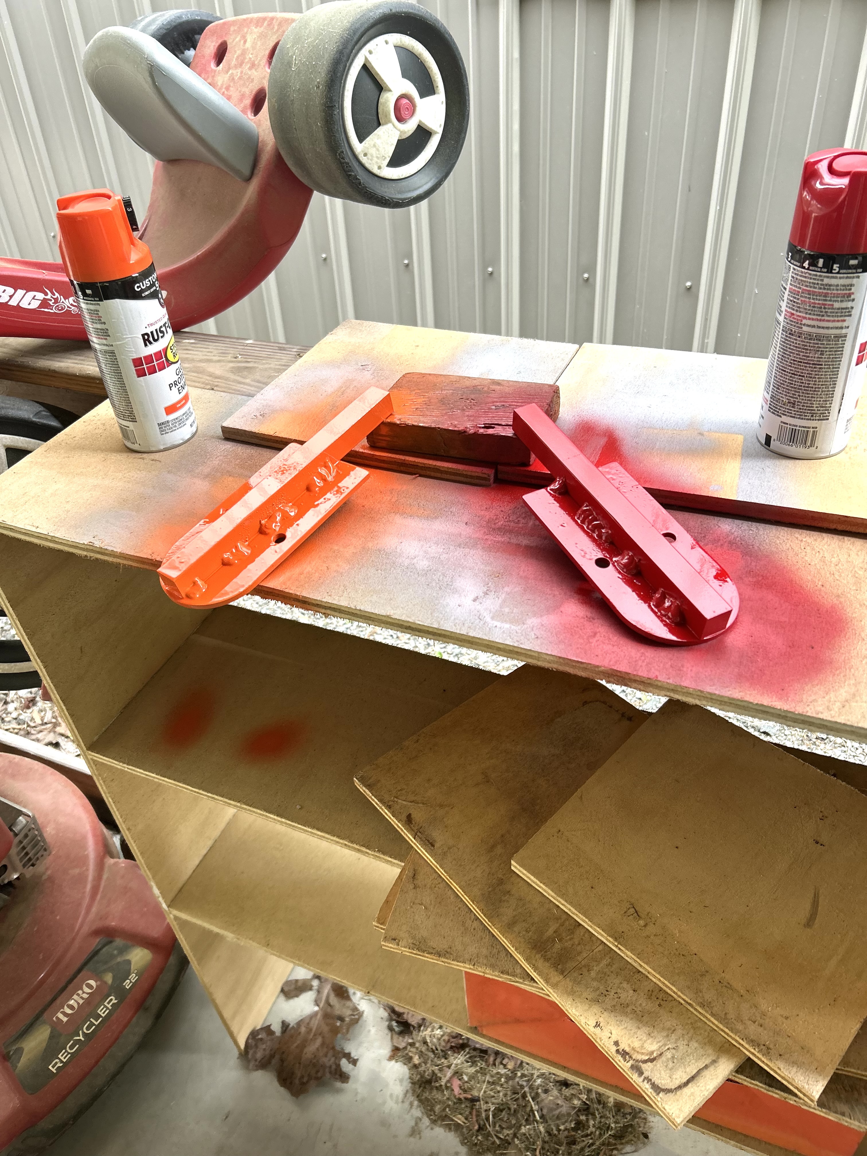

HFC3   Last of the engine compartment repairs.   May 17 2026, 02:02 PM
HFC3   Replaced a section I had already repaired. Fit w...   May 17 2026, 02:04 PM
HFC3   Jack point lifts. 3/4” solid bar with rubber sle...   May 17 2026, 02:06 PM
HFC3   Rubber sleeves   May 17 2026, 02:07 PM
HFC3   Two for about $20 dollars plus my cheap lab...   May 17 2026, 02:09 PM
