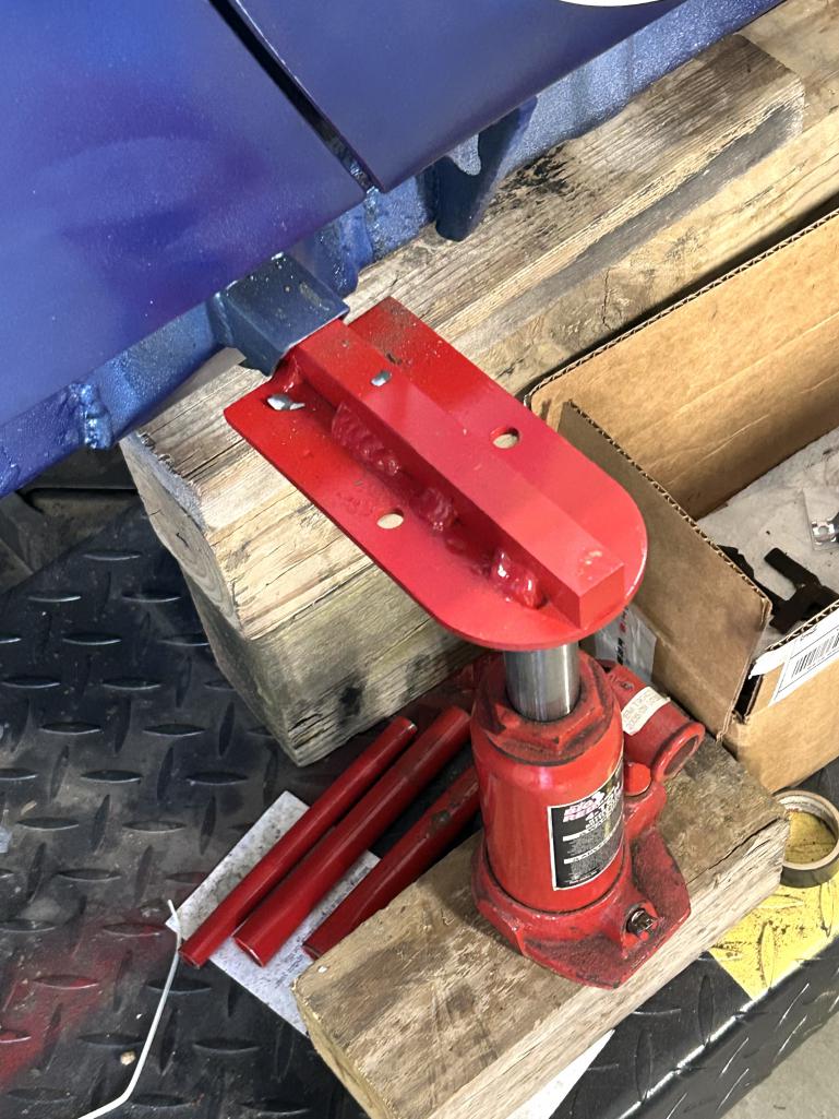

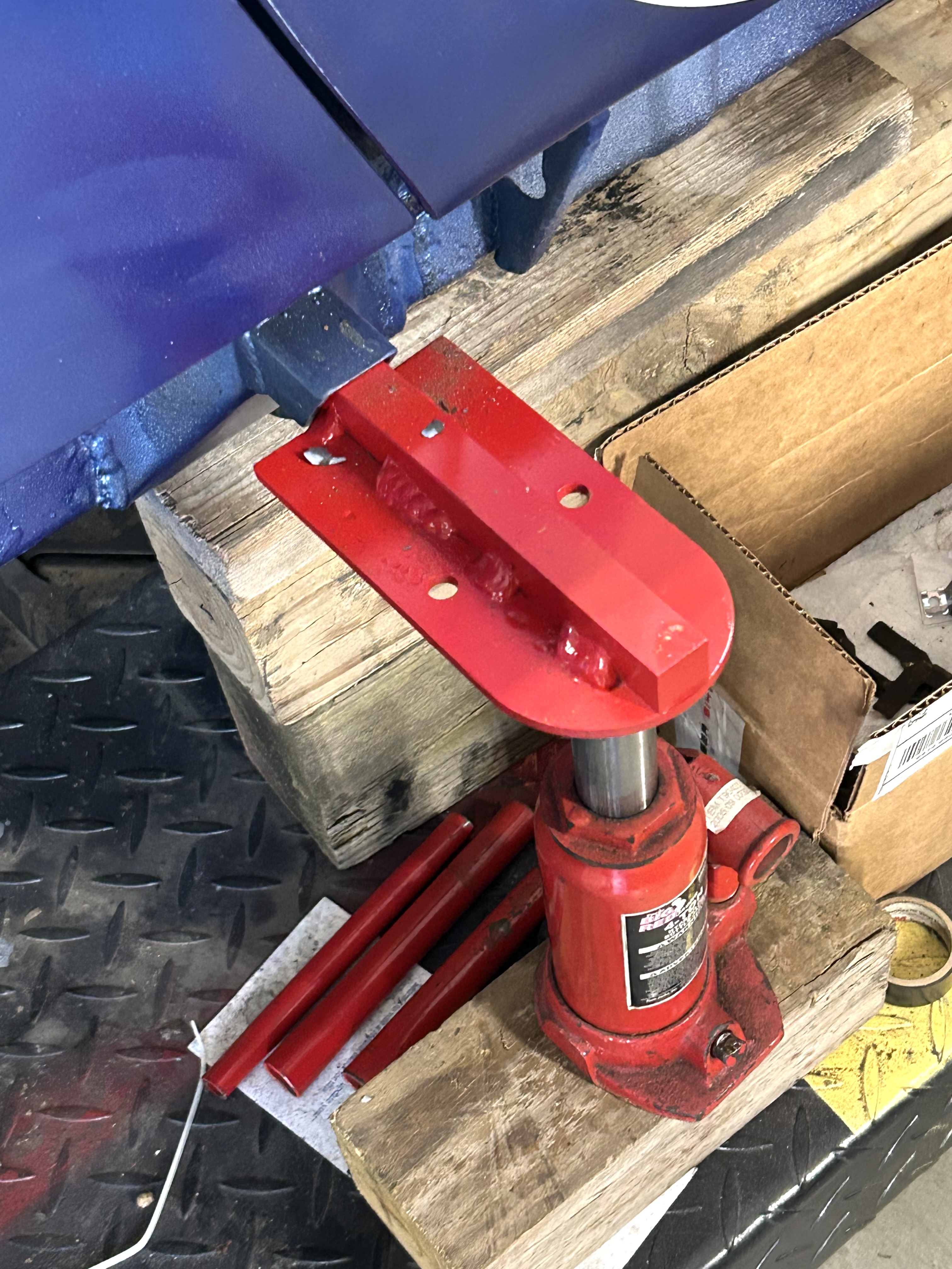

HFC3   Jack point lifts. 3/4” solid bar with rubber sle...   May 17 2026, 02:06 PM
HFC3   Rubber sleeves   May 17 2026, 02:07 PM
HFC3   Two for about $20 dollars plus my cheap lab...   May 17 2026, 02:09 PM
