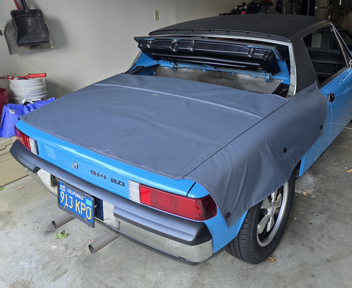

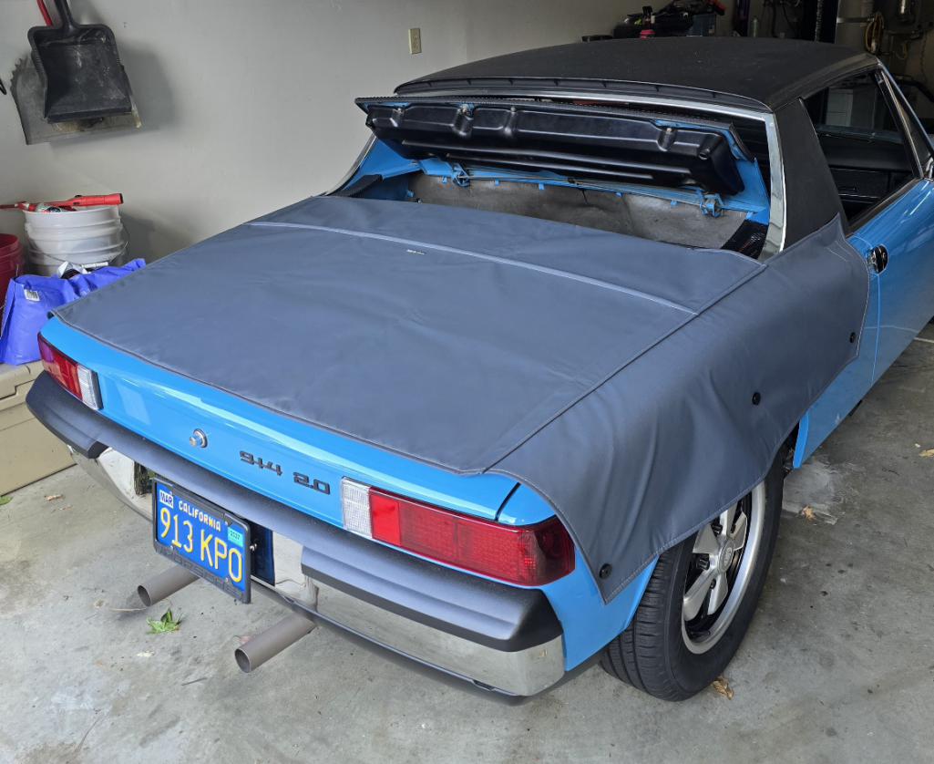

Thank you for the kind words and the recommendation on the PE.
In other news, my service apron showed up on Monday. Would have been great to have this a few months ago. That's my fault for not ordering it sooner. I think from ordering to delivery was just a little over two weeks.
Maybe tomorrow I will play hookie and play with the 914 to see if I can figure out this idle/lean situation. My smoke machine showed up on Monday as well. I am hoping its just a vacuum leak and then I will be good to go.
