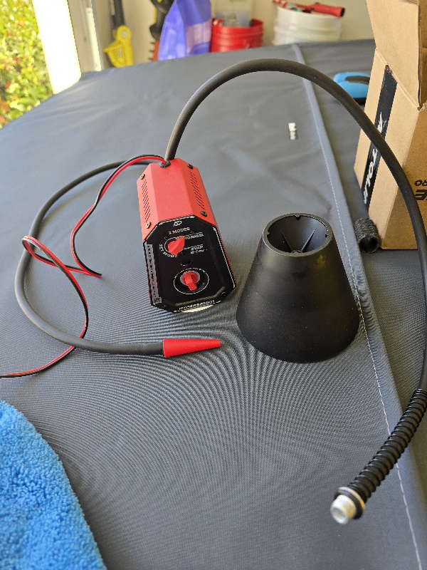

First thing I did was unpack the smoke machine that I picked up off Amazon. Best $65.00 I could have spent! Found three separate vacuum leaks! One at the oil filler / breather box flange. That's on me, I knew I didn't put the o-ring in there and made a mental note to put that in before I tried to run the motor. (DOH!). The second was on the big thick hose that runs from air bellows to the oil filler/breather box. The metal nipple on the bellows was allowing air to get in/out. The third was a split in one of the hoses that connects to the air intake plenum. That was a new hose too. I corrected those three issues and then tested the system again with the smoke machine.

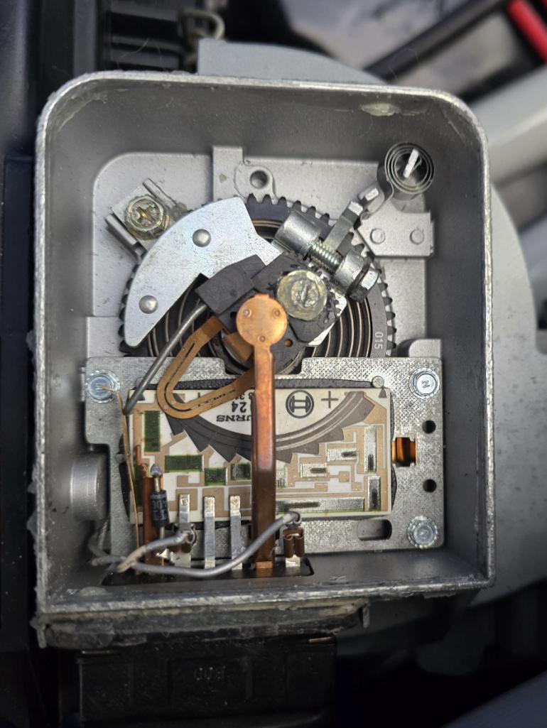

This time the cone kept popping off the intake bellows before I could find any leaks. I took that as a sign that we had caught everything and the pressure was building up high enough to pop the cone off. NICE!
From there I fired up the car and the PE wideband. and found that the excessively lean issue was completely gone. I then turned my attention to the Air Flow Meter. I popped the cap off and fainted. That looks like a Rube Goldberg machine. Once I regained composure, I checked the Air Bypass screw and found that it was completely bottomed out. I backed it out to 4.5 turns and started the car. Things were better for sure, but back to lean at idle. I noodled with the timing a bit more and at 2.0 turns out, the car idles at about 1k rpm. Noodling more with the timing... I can get the idle under 1k but then the car goes lean again.

Once the timing is locked in... I will re-read this post, pray, and maybe try noodling with Air Flow Meter contraption.

The magic box:
I was kind of surprised at the size. On Amazon, in the photos it looked bigger! I thought it would be the size of a car battery. It's tiny. The cone attachment is the key for these 914s.

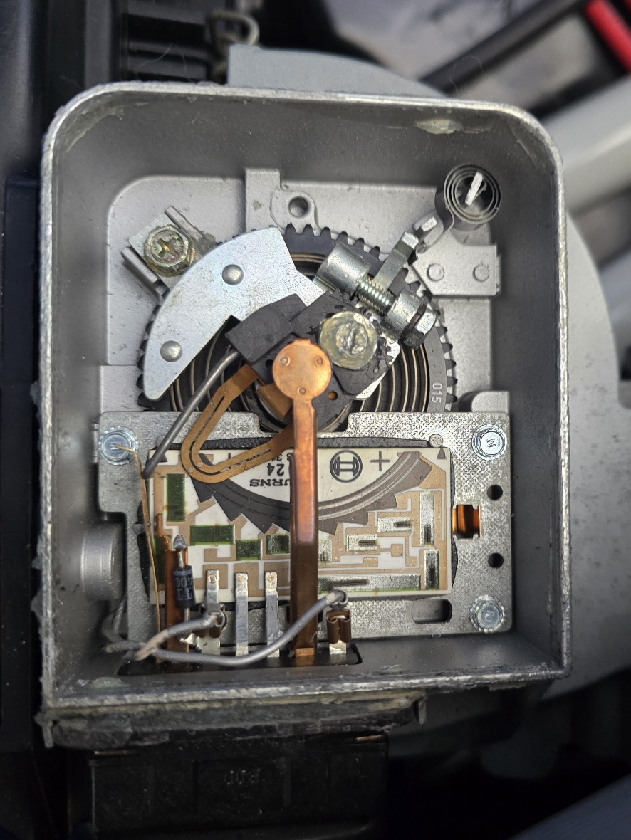

The voodoo contraption. Even after reading the post shared above, I'm nervous to turn any of those screws. Other than that, it looks nice and clean. It works really well, when the car is idling you can see everything moving as it should.

Ninja   Inside the AFM is where the AFM tension wheel is l...   May 12 2026, 03:03 PM
TRP   Inside the AFM is where the AFM tension wheel is ...   May 12 2026, 03:19 PM

Root_Werks   Don't be afraid to adjust (tiny amounts of cou...   May 21 2026, 01:21 PM
TRP   Don't be afraid to adjust (tiny amounts of co...   May 21 2026, 01:45 PM
