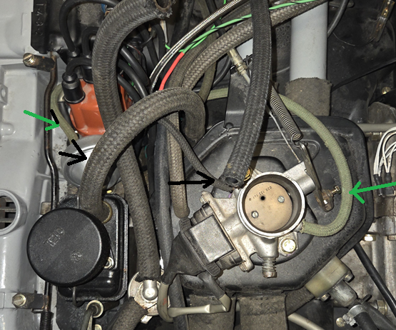

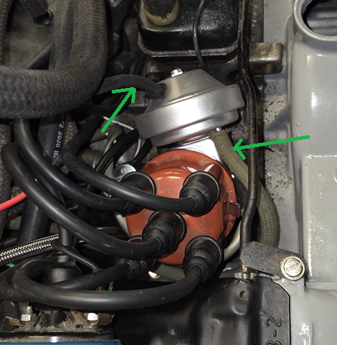

I have the ECU open and don't see any numbers on it either. Its kind of hard to talk about the vacuum hoses and distributer. Here are some pictures.

trojanhorsepower   I have the ECU open and don't see any numbers ...   May 22 2026, 05:08 PM
emerygt350   Looks good. To simplify troubleshooting you may w...   May 22 2026, 05:56 PM
