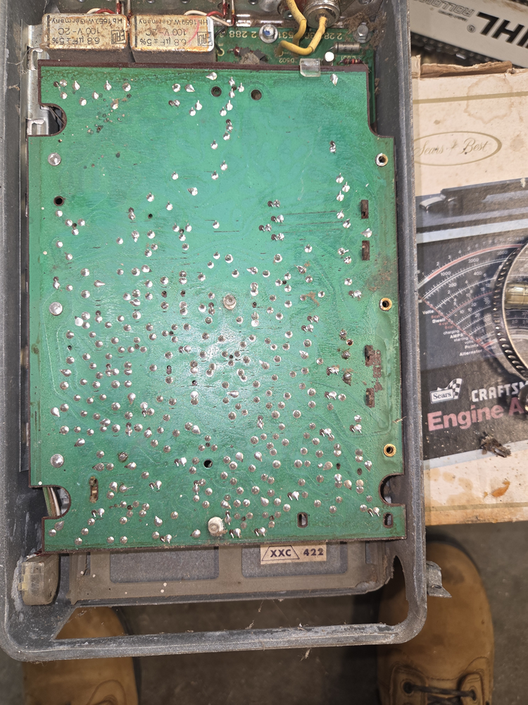

trojanhorsepower   I have the ECU open and don't see any numbers ...   May 22 2026, 05:08 PM
emerygt350   Looks good. To simplify troubleshooting you may w...   May 22 2026, 05:56 PM

Olympic 914   There should be a label inside the ECU where the h...   May 23 2026, 04:02 PM
trojanhorsepower   This is the insides   May 23 2026, 04:55 PM
