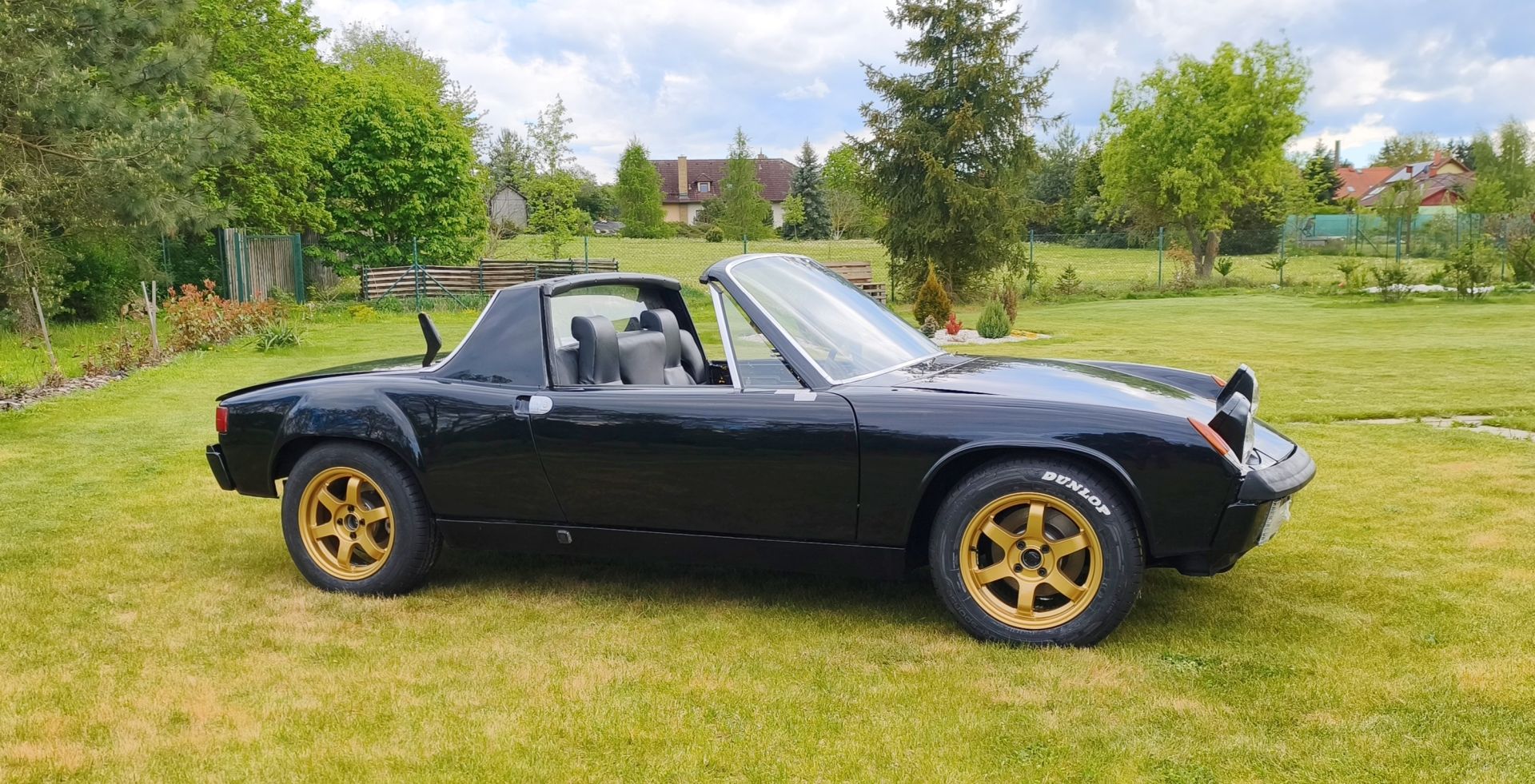

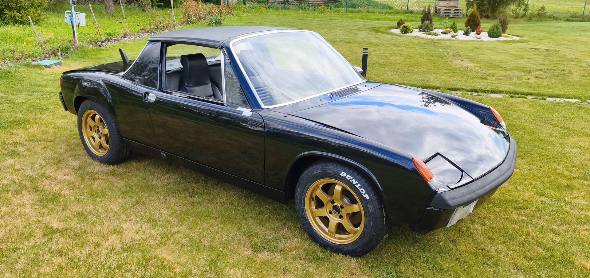

My new tyres and wheels finally arrived so I pushed the car out from my garage to see it in daylight for the first time.
15x7 ET40 with 195/60 tyres and 25mm cpacers from 4x130 to 4x100
