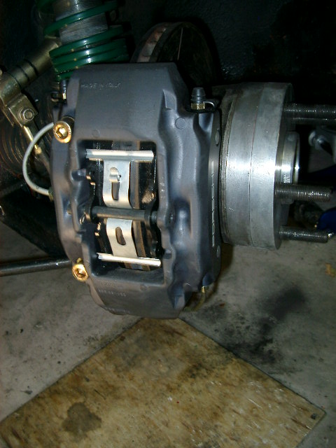

Front and rear on my car. No issues with wheel bearings or ball joints during 23 years of club racing. Much change on the scrub radius though.

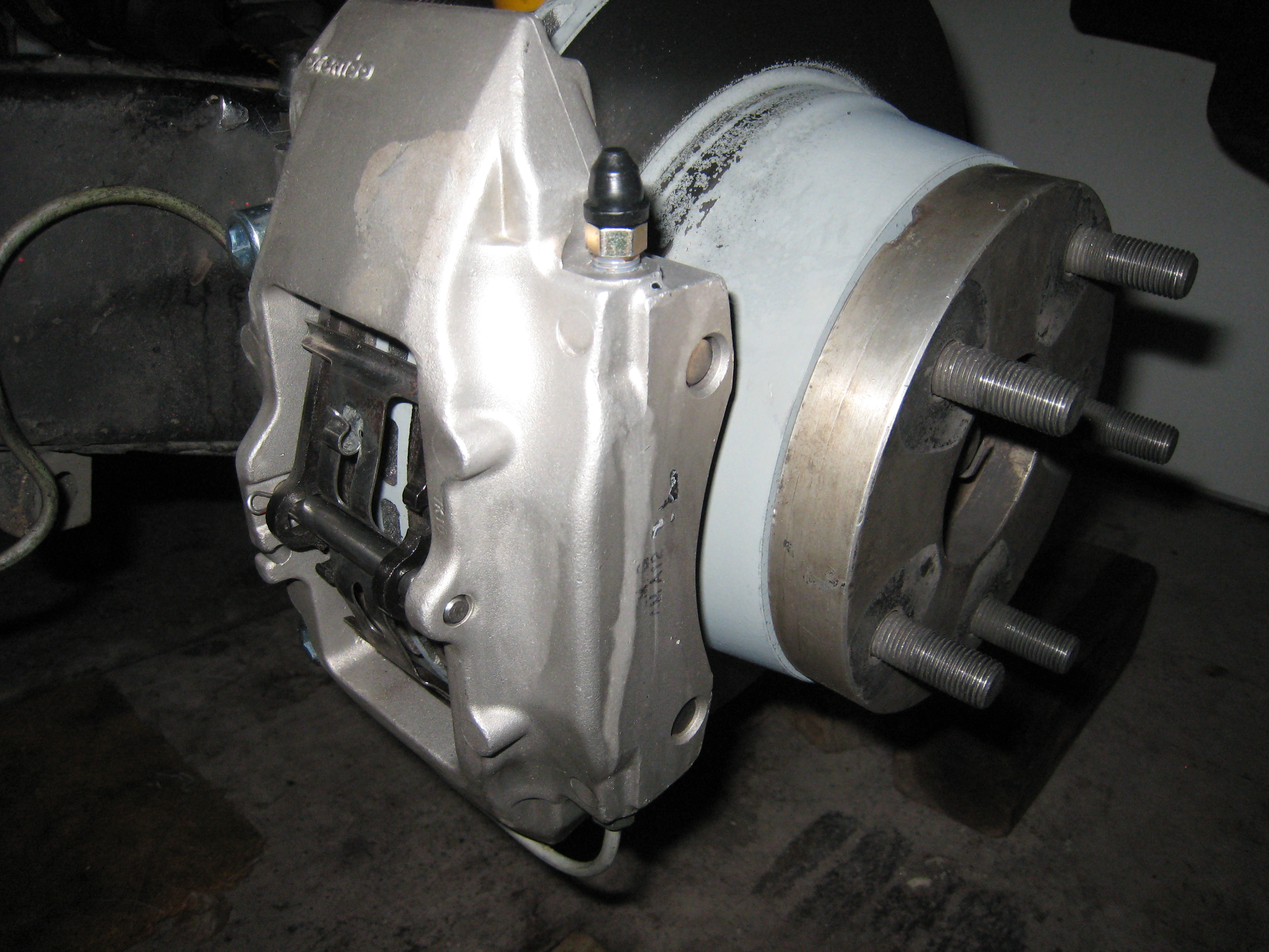

stownsen914   I've also not been a fan of the adapter style ...   May 23 2026, 11:22 AM
mlindner   Yes Porsche did. This is my 1998 Carrera S, wide b...   May 24 2026, 05:28 AM
mlindner   Just FYI, also have them on my 914-6 GT Tribute fr...   May 24 2026, 05:52 AM
GregAmy   Spacers, regardless of material, are not in and of...   May 24 2026, 06:35 AM

campbellcj   Same on my car; spacers F&R for >15 yrs and...   Jun 3 2026, 07:49 AM

sixnotfour   A bit of Lathe work,, Upgraded Rears.. 5-lug spec...   Sep 9 2026, 02:28 PM

sixnotfour   @914werke , These are not move out, But does have ...   Sep 9 2026, 09:03 PM
