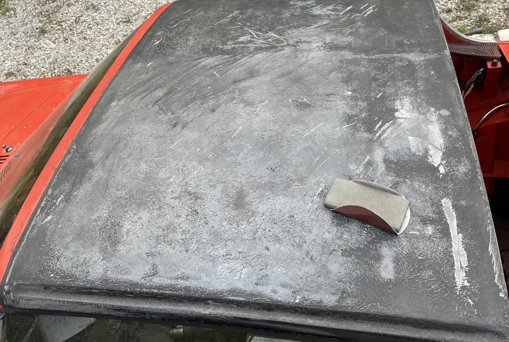

The targa top on this car was in bad shape. The finish, which I don’t know whether it was original or not was severely sun damaged and peeling all over. And on top of that someone had taken what looked like a flat screwdriver and tried scraping it in various places… leaving deep gouges. So I decided to try and refinish it, or at least improve it.

Literati914   The targa top on this car was in bad shape. The fi...   May 29 2026, 09:02 PM
Literati914   After sanding smooth and some filler, this pic is ...   May 29 2026, 09:04 PM
Literati914   I picked up a 1 gal. Herculiner roll-on kit, unuse...   May 29 2026, 09:10 PM
Literati914   The kit came with textured rollers and I did use s...   May 29 2026, 09:14 PM
