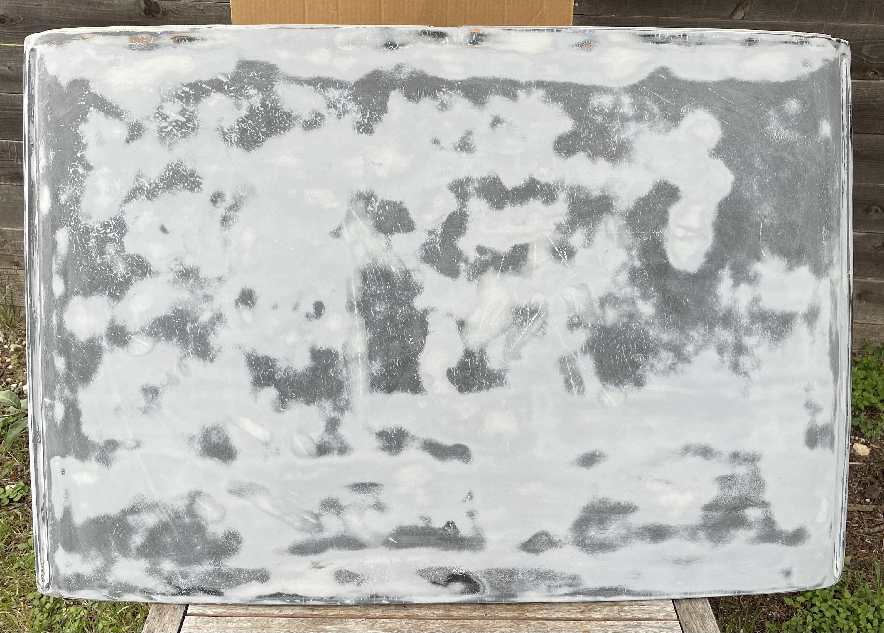

Literati914   The targa top on this car was in bad shape. The fi...   May 29 2026, 09:02 PM
Literati914   After sanding smooth and some filler, this pic is ...   May 29 2026, 09:04 PM
