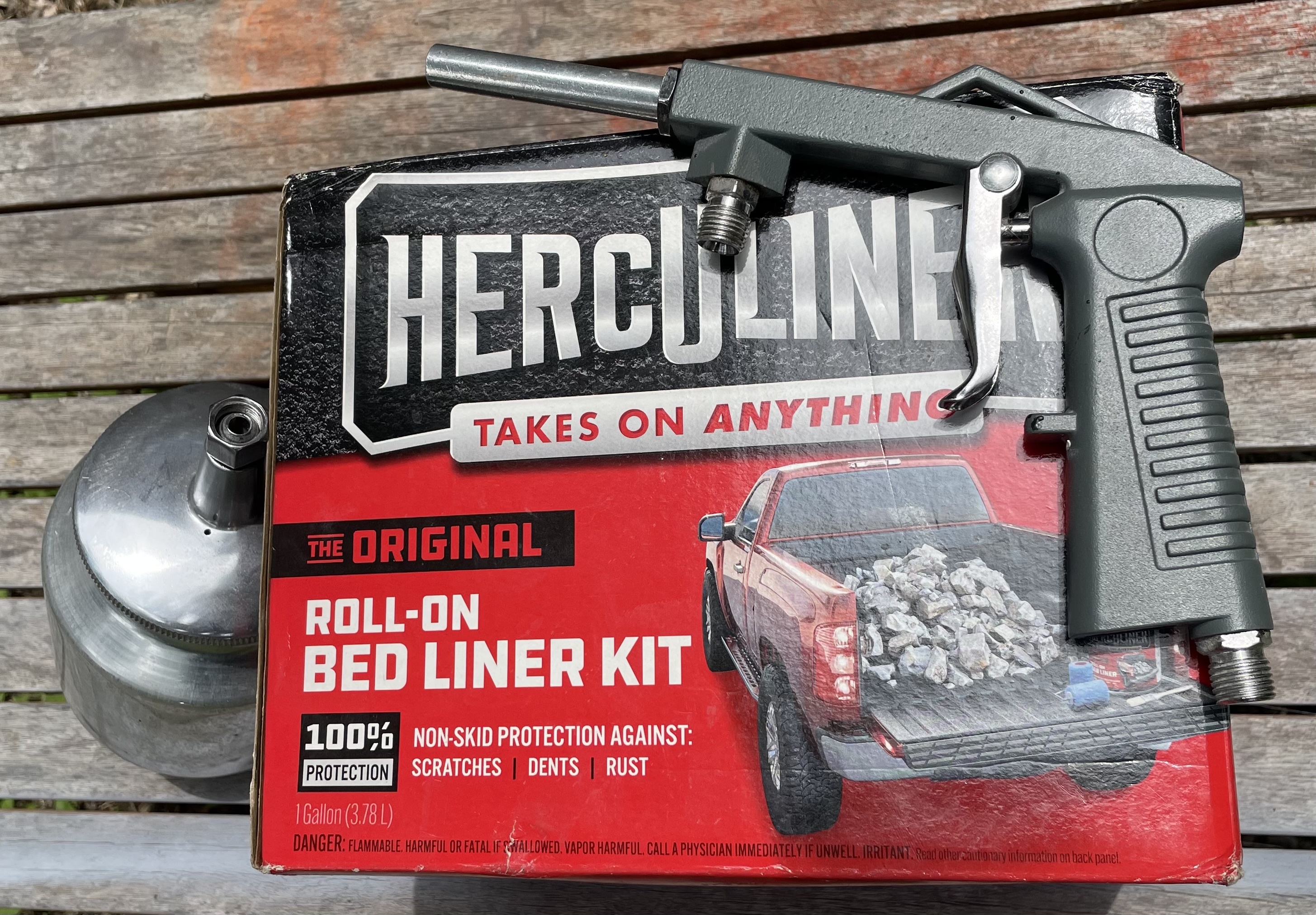

I picked up a 1 gal. Herculiner roll-on kit, unused and very cheap off marketplace with the intension to thin it if needed and spray it from a schutz gun. I basically decided to try rolling it on at the last minute because I didn’t feel like going thru the trial and error with air Psi and product volume.

Literati914   I picked up a 1 gal. Herculiner roll-on kit, unuse...   May 29 2026, 09:10 PM
Literati914   The kit came with textured rollers and I did use s...   May 29 2026, 09:14 PM
