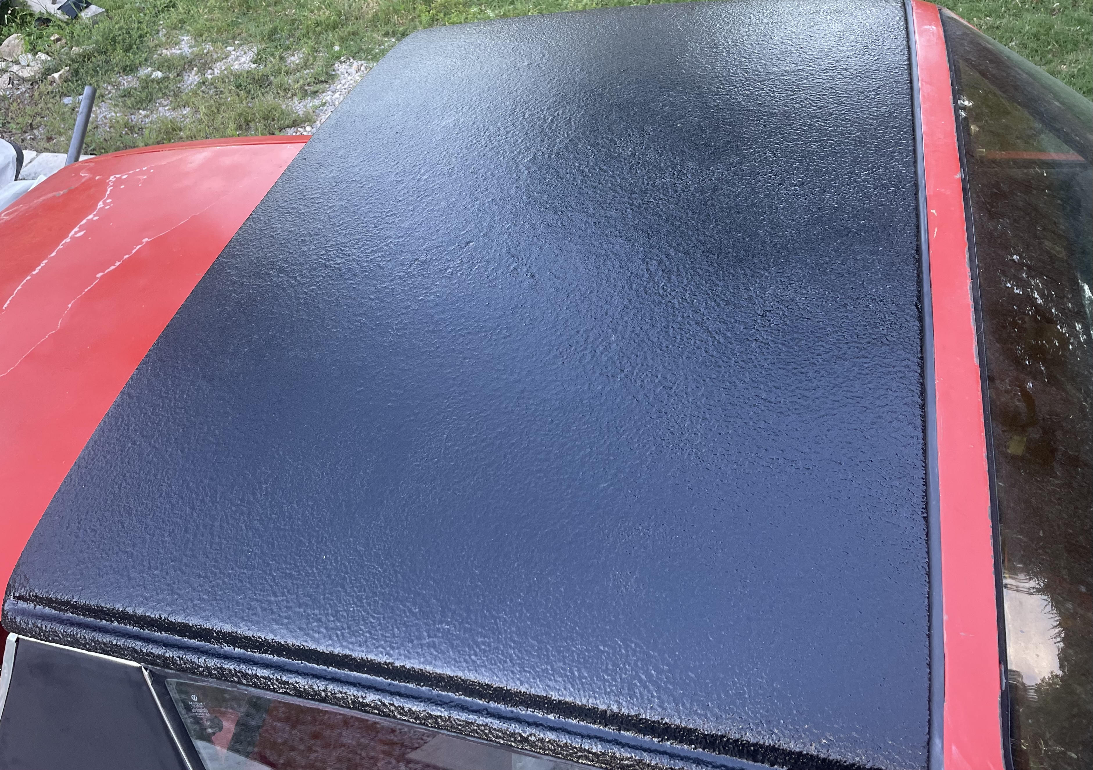

The kit came with textured rollers and I did use some acetone to thin it after mixing it really well. I applied 4 coats, not waiting for the previous to dry - just one after the other. It came out better than I expected, perhaps not strictly a factory texture but pretty close and pretty nice - a great improvement imho.. though next time I’d probably just do 3 coats.
