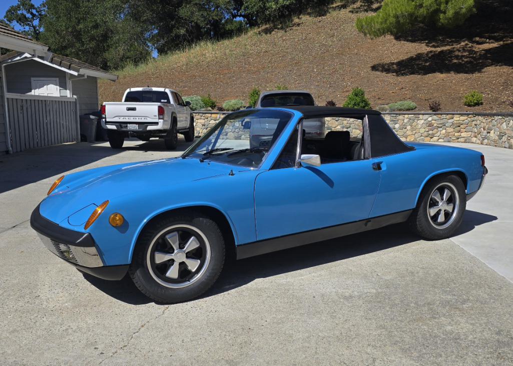

Wrapped up a bunch of final checks and double checks. Still a bit rich under power,but I was able to take ot for its first shakedown run today. Lost all gears except third after about 10 minutes. Limped it home. Also found that it was slow to return to idle.
My guess is clutch cable needs adjusting.
