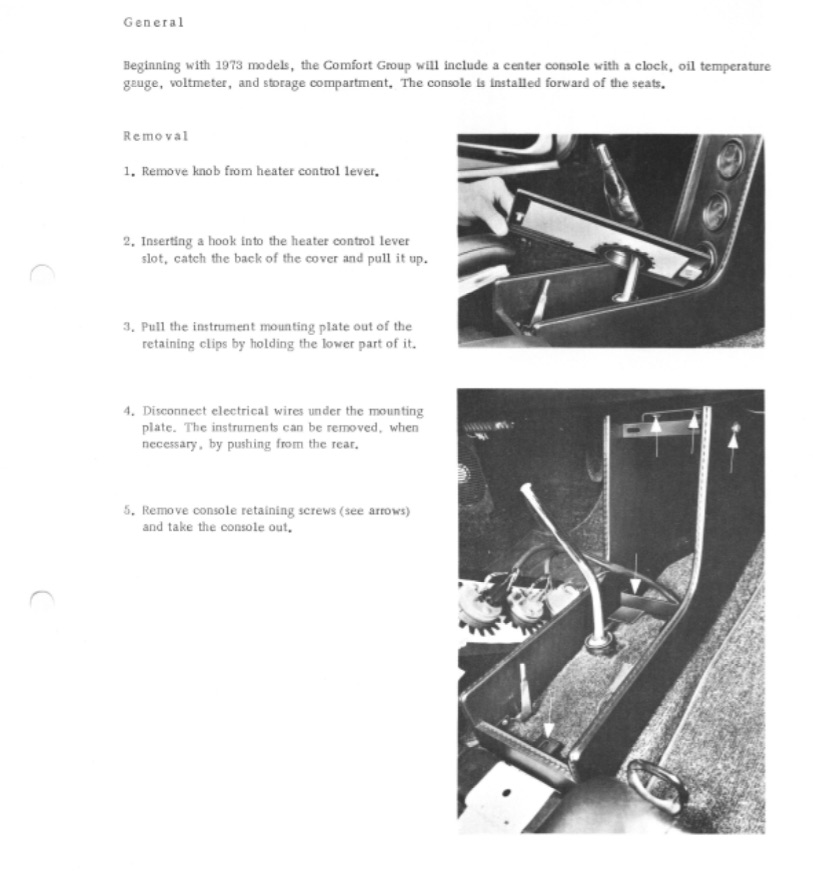

My car did not originally come from the factory with a 3-gauge center console.
PO installed one. I recently swapped that one for a cosmetically better one. Did cars that came from the factory with a console have a full-length piece of carpet under the console, covering the tunnel and around the shifter just like cars without the console? |
| wonkipop |
Jun 6 2026, 08:17 PM
#2
914 Guru ![]() ![]() ![]() ![]() ![]() Group: Members Posts: 5,539 Joined: 6-May 20 From: north antarctica Member No.: 24,231 Region Association: NineFourteenerVille
page from factory workshop manual.
carpet is there. tells you to remove gearshift knob. thats pretty tedious (given how fragile those f#$kers are). i assume the gaiter won't get past the knob? (thanking my lucky stars now i don't have a console, instead the storage bin which is very useful). i would have thought you could manouver what remains of the console around enough with the bottom panel and guage panel out and some screws loosened to lift the carpet. its a moulded carpet if factory and not glued down. and kind of leave everything there but out of the way to get at the base of the shifter. |
