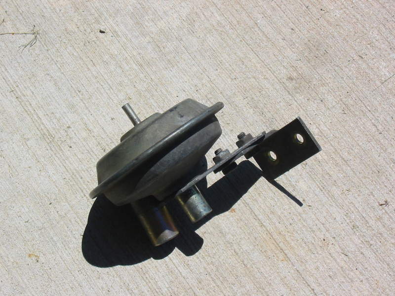

QUOTE(TRP @ Jun 7 2026, 09:35 PM) *
The most interesting part is that the car is slow to return to idle and often hangs between 2k and 1800 rpms. If I leave it in gear and drag the brakes the idle will drop to 1k rpms. Need to figure that out. I am feeling pretty encouraged about the progress so far. Car drives well, no squeaks or rattles.
Figure out why the car hangs at 1800-2000 rpms at idle.
Drive it!
decel valve might be the reason for that.
adjustable. has a nut on the end.
somewhere on the site is a thread on that and the vacuum value to adjust it to.
i'd have to try and search that out.

I was hoping you'd join in here! (IMG:style_emoticons/default/biggrin.gif)
I just read that 5 page thread! I have a 75, is mine still adjustable? I thought the 75s had a different style valve that wasn't adjustable.
Mine looks like this (this one isn't mine, the one in my car is still kind of gold-ish):
I will test it tonight by clamping the hose that goes to the intake boot and see if that fixes the issue. If that brings the RPMs down I will dig into it more.
I'm really happy with the way the car drives right now, if I can fix the hanging RPMs it will be mint.

wonkipop   The most interesting part is that the car is sl...   Jun 8 2026, 12:05 PM
TRP   The most interesting part is that the car is s...   Jun 8 2026, 03:44 PM
wonkipop   ah yes, forgot the 75 has that different valve. th...   Jun 8 2026, 04:02 PM
TRP   Im going to hook the smoke machine back up in the ...   Jun 8 2026, 04:24 PM
930cabman   Im going to hook the smoke machine back up in the...   Jun 8 2026, 04:34 PM
TRP   Im going to hook the smoke machine back up in th...   Jun 8 2026, 05:05 PM
930cabman   [quote name='930cabman' post='3260538' date='Jun ...   Jun 8 2026, 07:06 PM
wonkipop   Im going to hook the smoke machine back up in the...   Jun 8 2026, 05:19 PM
TRP   Sooooo.... I have been trying and trying to get th...   Jun 20 2026, 08:54 PM
wonkipop   Sooooo.... I have been trying and trying to get t...   Jun 21 2026, 12:11 AM
TRP   I wonder if you can fit the older style decel val...   Jun 21 2026, 03:39 PM
