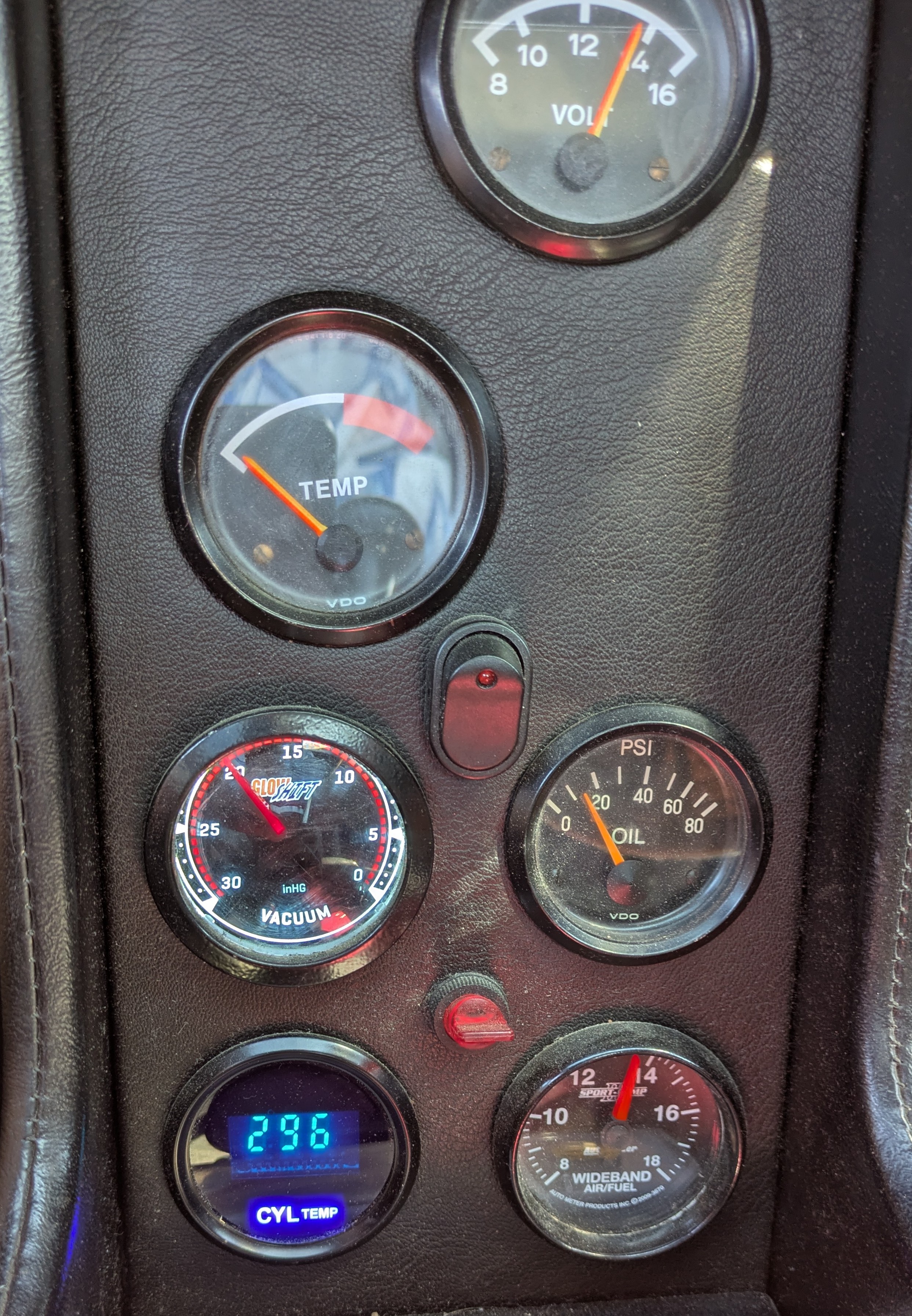

After I loaded my clubs into the car I headed to the driving range (5 miles at 30mph). Pulled into the parking area and snapped these pics.
Notice the cht and the oil temps
This is a 200c oil temp sender.
All photos taken at idle 900rpm

QUOTE(emerygt350 @ Jun 9 2026, 08:21 AM) *
This is what I was saying about flap control being independent of oil temp. Flaps are in the full hot position and oil has a ways to go still.
Oil temp control has two variables, the air over the cooler controlled by the flaps (unrelated to the state of the oil) and the oil flow through the cooler controlled via pressure which creates some interesting cooling problems related to oil weight and/or the condition of your pressure relieve valve.
