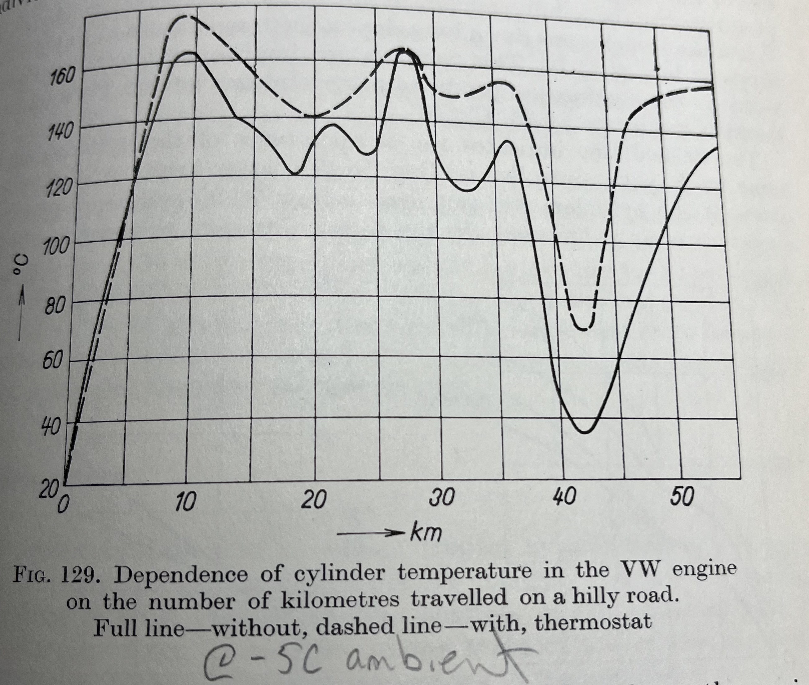

You may appreciate this data which is representative of your situation in the mountains.
From Air Cooled Automotive Engines; J. Mackerle
The important point to note is that you don’t really want cylinder temp going below 70C and how the thermostat prevents that from happening on the decent.
Also note that temp consistency is improved. Higher, more consistent temp = less friction losses.

QUOTE(Superhawk996 @ Jun 9 2026, 09:30 AM) *
That's a great find and does reflect what I have experienced.
I wonder what motor/induction was used here. This all has me thinking about ways to utilizing tuning on modern ECUs to better regulate temperatures. This is something I have implemented to some extent but only focusing on keeping temperatures down. Now im wondering if there are things I can implement to increase temps under cold decel situations as it looks like even with the flaps the cooling is pretty pronounced.

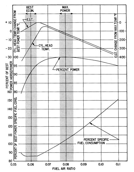

QUOTE(JamesM @ Jun 9 2026, 06:00 PM) *
I would think you could get something by running a lean burn and advance timing short of decel fuel shutoff that might help but may be difficult to tune without knock sensors.
That data that I posted is ancient - that book was 1st published in 60’s so I would almost guarantee that was a carbureted engine.

QUOTE(Superhawk996 @ Jun 9 2026, 04:32 PM) *
Lean burn with advanced timing is how my heads are running 75 deg cooler than stock at cruise as it is (IMG:style_emoticons/default/biggrin.gif)
Head temps drop off quicker on the lean side of stoich than they do on the rich side. Added bonus I get near 40mpg and my oil stays way cleaner too, which itself should be better for engine wear.
Around stoich is the hottest but limiting that to only during conditions where you are experiencing extreme cooling would be the challenge.
Driving down a mountain in freezing weather is a bit of an edge case for me given they salt the roads here in winter so for now ill take the trade off, but its an interesting problem to think about.
