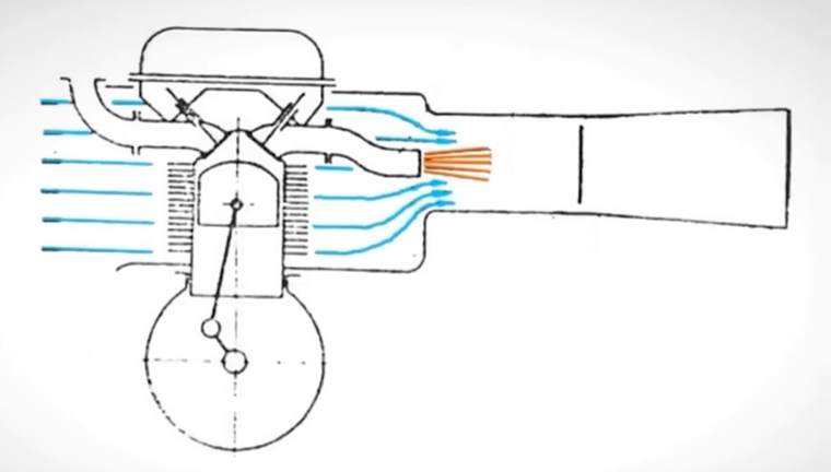

In any “aircooled” engine there is a balance between air cooling and oil cooling.
Oil has a higher thermal cooling coefficient than air. Meaning, it is more effective at removing heat than air. Not as good as water but a lot better than air.
You can see this increased reliance on oil cooling as the 911 engine evolved. The addition of piston oil squirters being an early modification that used oil to cool things as HP continued to increase beyond the original 2.0L’s modest 100-110 HP.
The 911 uses oil cooling to a much greater degree than the T4 engine. This can be seen in the size of the oil cooler on the engine as well as the early trend toward external loop coolers on the early “S” variants making higher horsepower.
The 911 engine uses a thermostatically controlled oil cooler as its main temperature control strategy. As James pointed out earlier the T4 oil cooler oil flow is largely uncontrolled other than the gross pressure control that bypasses the cooler when oil pressure is high enough to actuate the bypass valve when oil is cold and viscous.
I wish I had more data on that balance of air vs oil cooling between the T4 and the 911 during the early warmup phase.
There were other cooling strategies used by other air cooled engines like Tatra’s that used thermostatically controlled clutches on the cooling fan to control air flow instead of using VW’s flaps or the 911’s oil thermostats.
Extra credit if anyone has ever seen or driven an aircooled Tatra V8 with ejector cooling using exhaust gas flow and a Venturi effect to control cooling air and engine temperature.Attached Image
