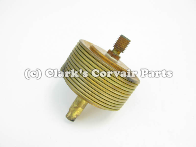

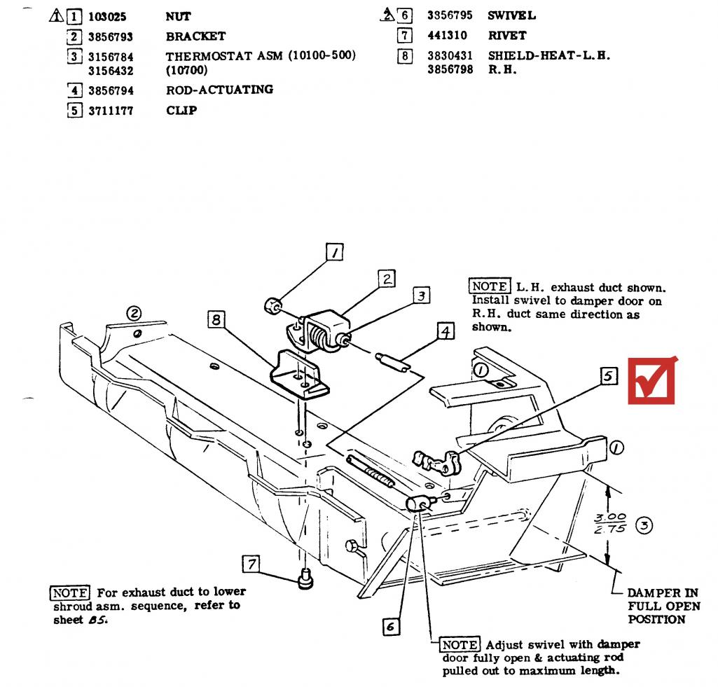

A tatra?
How about a flat six aircooled "Merican" car?
Corvair with a bellows style T-stat.
