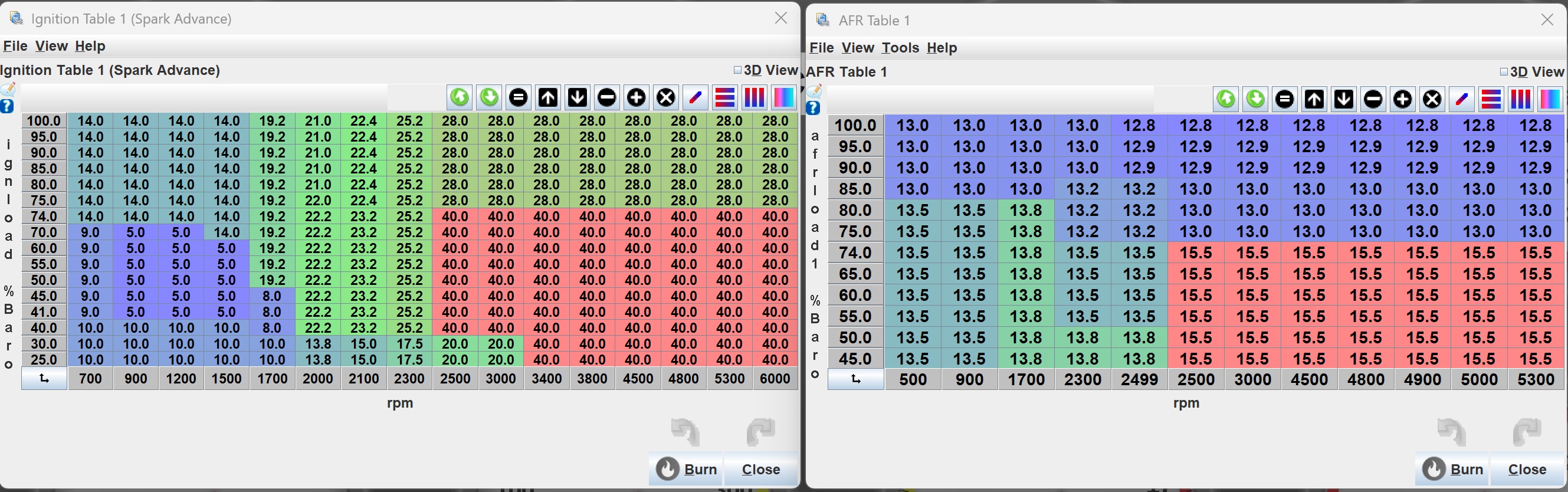

@jamesm
Would you share your microsquirt tables?. I’d like to try your lean burn on my 2056. I’m curious what they look like.
JamesM
post Jun 16 2026, 09:02 PM
Posts: 2,254
Joined: 6-April 06
From: Kearns, UT
Member No.: 5,834
QUOTE(rudedude @ Jun 12 2026, 05:20 AM) *
@jamesm
Using my VE tables will do absolutely no good as you have a different engine and injection parts....
But here is the wizardry as far as igniting and AFR targets go.... copywrite me (IMG:style_emoticons/default/biggrin.gif) and im not responsible if you blow up your motor (IMG:style_emoticons/default/beerchug.gif)
Not fully refined to my liking but nothing ever is. This is the same setup I used on the test drive from Utah to California were I managed 37mpg and never saw over 350 head temps, most of the time they were below 300, on a bone stock 2.0 motor.
A couple things to note about tuning to these targets: First is that it is a bit more difficult to dial in your VE table vs a smoothly blended target map. You will notice the abrupt transition and uneven progression of load bins at 74, 75kpa. This is intentional and part of the magic to keeping the engine in areas running the coolest. The non linear nature means the engine ever sees the AFRs that cause the highest temps
You will need to have all your engine states/vacuum thresholds/switch points defined properly for the vacuum signature of your specific engine as well or you may wind up with drive ability issues, and depending on how different the vacuum profile is of your motor you my even need to change the load and or RPM at which the transition from cruise to load occurs.
