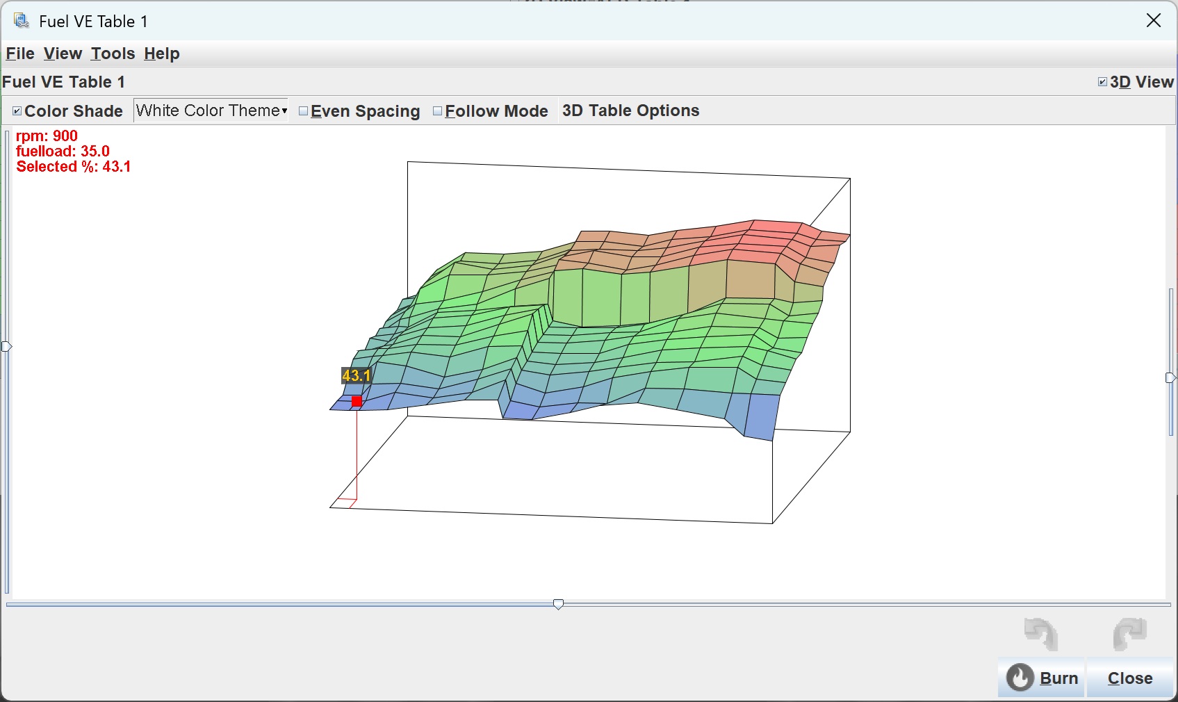

When dialed into the targets the VE Map winds up looking something like this.
And if you have ever looked at what the fueling curve (keyword curve) for d-jet looks like it becomes very obvious why you can only run like this with a fully mappable system.
The parts of the curve that we are abruptly transitioning over though, those are the areas that generate the most heat.

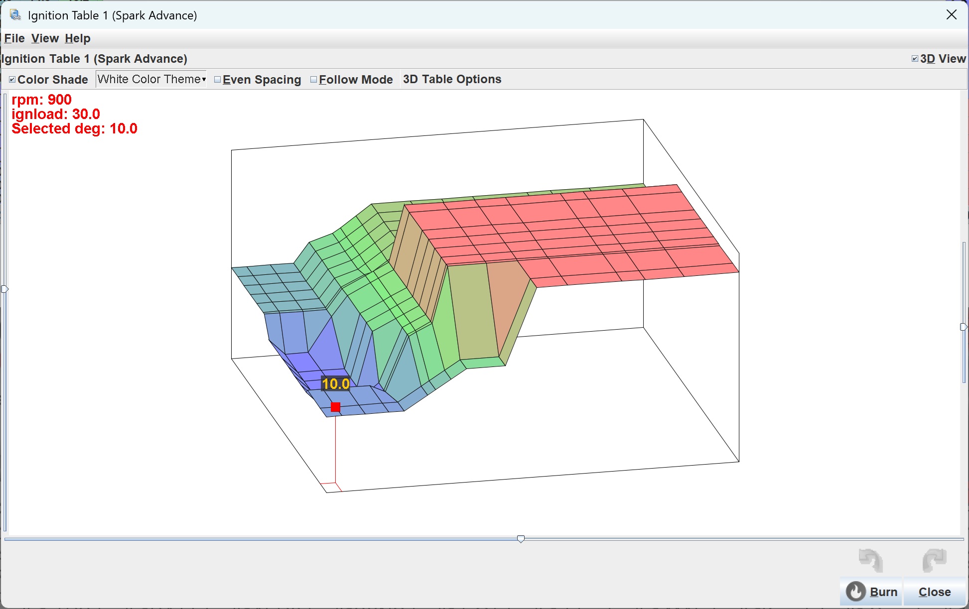

Ignition table to match.
Where the fuel map instantly transitions the lean burn, the advance immediately increases in step
